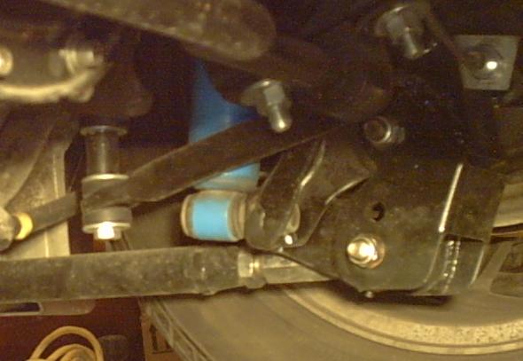

Hey Schultzy89GTA, it looks like those relocators hang kinda low, I don't know if it's the angle of the shot or not, but I was wondering if you had any ground clearance problems. I'm planing to get the lca's, relocators, and a panhard from Spohn, but I want to make sure there'll be no big problems.
The Relocation brackets do not hang down below the wheel so there are no clearance issues there. I have all three of those pieces and have had 0 problems. I couldn't find a pic. If you need one let me know and I can take one for you.

Here's a pic (again- the moderators are going to shoot me) of my BMR bolt-in units/also welded. They will work with any LCA's, even the stock units.
