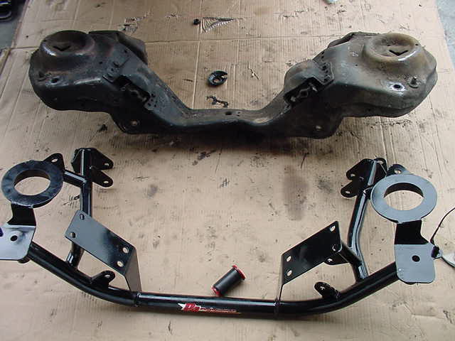

Yes you can move it from side to side the pins only locate the K-member front to back in the car. The slots in the body are about 7/16 longer than the pins for side to side movement.
I had to move my PA K-member after install the K-member was to far to the driver side. The drivers header hit the steering shaft and all I did was unbolt and used a big screw driver to push it over now I have the same room for the drivers header.
When you move the K-member the camber will change on both sides (one more and one less camber ) also the steering wheel will move off center the toe and caster will stay the same.
If you need a better picture I can take better one.
Jerry
