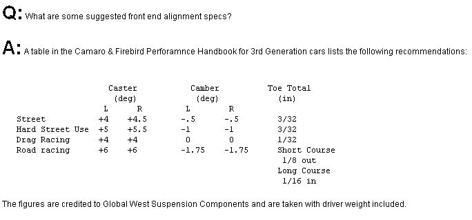

Needs the maximum settings for handling and racing. What is the recommended caster, camber, etc.
Thanks.

well if you are talking autox then use as much negative camber as possible. then as much positive caster as possible. to set for .06* total.

I set mine to -.5 degree camber,+4.5-5 degrees caster,1/16 toe in.

Well the suspension guru Herb Adams recomends,
Street,
Camber -1
Caster +3
Toe 1/16".
Autocross
Camber -2
Caster +5
Toe 1/16"

Well what would the best "blend" be??

https://www.thirdgen.org/techbb2/att...postid=1180408

Thanks, I guess hard street use would be it?!. If that would be the best compromise between racing and handling.
