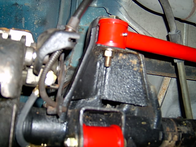

Well I put the new rear in that has disk brakes and the ebrake cable seems too long. The cable is in compression. Do I need new cables from a disk brake car or am I doing something wrong?

yes you need ebrake cables for a disk rear

I second that... You can get the disc ebrake cables from the equilizer back... they will fit right in...

Well, now that makes sense. I guess thats one of those details people forget to mention when they do these swaps eh?
