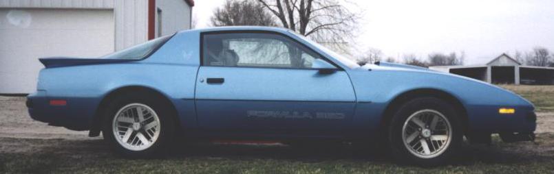

I'm running old boxed type spohn SFC's with my edelbrock TES with dual cats and it clears fine.
Spohn makes his SFCs with a indentention where the exhaust part is.
This is a crappy picture but you can kind of see where the reds ends about halfway on the passengerside door. The SFC keeps going it's just designed so it tucks in closer to the body to clear the exhaust.
