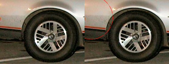

OK, here’s a pic of my ratty formula with some 275/60/15 BFG DR’s on the back (and 215/65/15 GT+4’s on the front). It is at slightly lower then stock ride height.
If anything, it looks like the tire is a little closer to the back of the wheel well then it is to the front, and if it wasn’t for that dented in portion by the LCA (which is easily cut, reshaped, moved and patched), that there would be more room in the front of the wheel well then in the back
Attached Thumbnails Whats the biggest size DR I can fit?-c-documents-settings-mark

Actually, here, a bigger shot. I don’t know if you can see it in the first pic, but there is the dark outline of the spare tire pocket inside the wheel well there… in this pic it’s practically touching the tire and I traced it with the red dotted line. I found later that it was actually rubbing the tire in that spot as well as the typical spot in the front of the wheel wells on both sides.

Can honestly say I dont have that issue. Did yours come with a full size spare??

It might just be the shorter then stock ride height. That tire was hitting right in the middle of the tread in that spot, actually worse then it was hitting on the inside front. I’m assuming that I’m not the only one that has the spare tire lump there…
