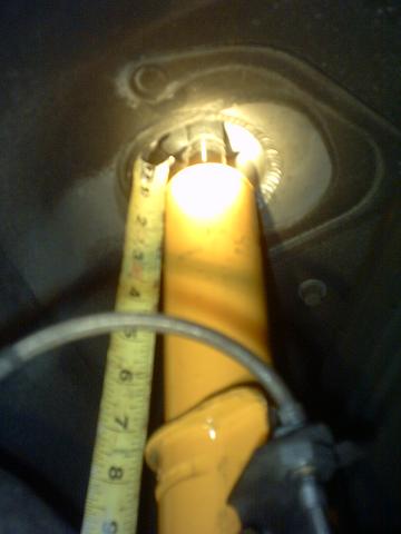

so if he test fitted them then what ID are they?
the site says 2.5". that will not fit over a bilstein hd strut. i am trying to get the point out that those who may have a specific strut must check to make sure it will fit before they buy them. pretty simple and not the end of the world but 2.5" is a standard sleeve and spring size. you can buy sleeves, adjusters and springs from the biggest name race companies for half that price. it's the package and upper plate support that can make the difference.
right now the only thing i see that might be worth the wait is the plate design, art morrison makes a very nice plate support which is only $65 for the pair but it is not a 3 piece. it would be interesting to see what the variables are that might make this design better.
also what is the spring dimensions? how tall? the spring rates on his site depending on how tall of a spring would really be way to harsh on the street. i had a 250lb rate with only slight weight reduction on the front end and i could adjust more upwards then down. incredibly harsh on the street to.
reguardless the price is on par with the other companies so everything else looks fine. just need to add that it will only fit certain struts so that the buyer doesn't get thrown off. as an example of pa racing website claiming that the 2.5" will fit.
Information: This kit will fit any stock type strut or stock replacement.

Kandied, The Koni strut body is 2.175". Do you have any idea what the O.D. of the Bilstein strut body is?
I know when we talked awhile back, Spohn was having his own sleeves CNC'ed. We had tried to fine other premade sleeves from various manufacturers but nothing is thick enough that would fit onto the 2.175 strut body. Art morrison, and PA both use Afco sleeves which are very thin and HAVE BROKEN during use- so again, Spohn has made thicker ones to be used with 2 5/8id coils.
Now about his 3part mounting system. Unlike both PA and Morrison, Spohns upper coil mount will mimic the angle of the strut shaft at all times making it a "true Coilover" design eliminating upper hat spring bind from a stationary mounting surface that doesn't follow suspension travel change in geometry.
So Spohns kit will work 100% free of coil bind- also with the added benefit of coil bearings for twist movement when steering.
Now- Why is he taking so long? Because he is test fitting and test driving the setup and improving any and all potential problems that can be faces with trying to use such a kit on various different vehicles with varoius different weights, ride heights, and comfort levels.

That is the major concern of just how low they can sit without grounding out.I have given Steve photos of my car sitting 2.25" lower than stock height and I would have trouble because I am extremely low. Hence why I am waiting to see if Belltech brings out the drop spindles again and just how much extra clearacne I'll have with the Belltech strut mounting pad height. If it will give at least 1" more room I can fit in a 2.5x8"tall 325 lb spring or even a 2.5x7" (SSS part #17280).
Right now if you look in the picture I currently have 7 1/2" of compressed hieght at max lowered threads. The Belltech's should give me 8 1/2 min which an 8" slightly compressed at ride height should set me about 7 1/2 - 7 3/4". I can go 7" tall if that still doesn't work for me. I also may have to alter my strt housing mount positon to give the upper body of the strut mount travel room also. Matter of fact, when I go to this I will have a custom made/custom valved strut built to my specs only because I run so low.
Attached Thumbnails Spohn coil over kits?-c-documents-settings-office
