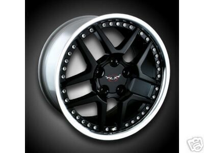

hey im lookin into these z06 wheels for my 83 z28 there Offset measurements are 17x9.5 +54mm what would i need to put them on?? and will they even fit in the wells? thanks

I was bored so i did the math for ya. I'd recommend a 2.25 inch front and 2 inch rear (unless your running a 4th gen rear)
Does that sound right to everyone else?
I actually came up with 2 1/8 but i think the only make them in 1/4 increments. And the rear you could get away with 1.5 but everyone recommends 2 inches on all 4th gen wheels.

2" up front.. i have 17x9.5's ZR1's
