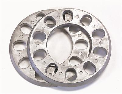

I have attached a pic of the spacer along with the lug nuts involved. The shinier one on the left is used for the front wheels if you do not have 1LE (or other stance-widening) brake upgrade. The lug has an elongated area past where it seats. That snout compensates for the spacer, so longer studs are not required.
The other lug is used otherwise.
The spacer is 5/16" thick. Try a Mr.Gasket 2371. Photo is below for comparison.

With the spacers shown above - make sure you center them perfectly before tightening down the rim. They are universal, and fit many vehicles, so there is quite a bit of slop in the holes. We also CNC machine billet spacers specific to the hub OD, bolt pattern, and wheel ID (if you wanted a lip to help center the rim), but they'll be a bit more expensive than the cast aluminum MrGaskets.

As for centering the Mr. Gasket pieces, what is the best method? I thought I would just line them up by eye on the back of the rims, and then hold them in place with a few dabs of RTV sealant or gasket maker or some similar substance when attaching rim. Good or bad method?

i would try anti-seize, that is what the stock rear ones use (although they are a perfect fit for the bolt patern) and they stick pretty good to the rim and/or to the drum.
