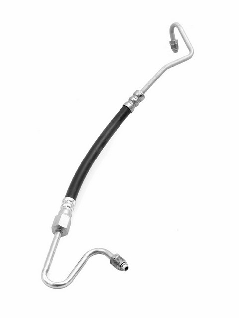

but you're right, 86TA. the steering box is tearing off. what is a good wonderbar? umi?
is this the hose i need?
