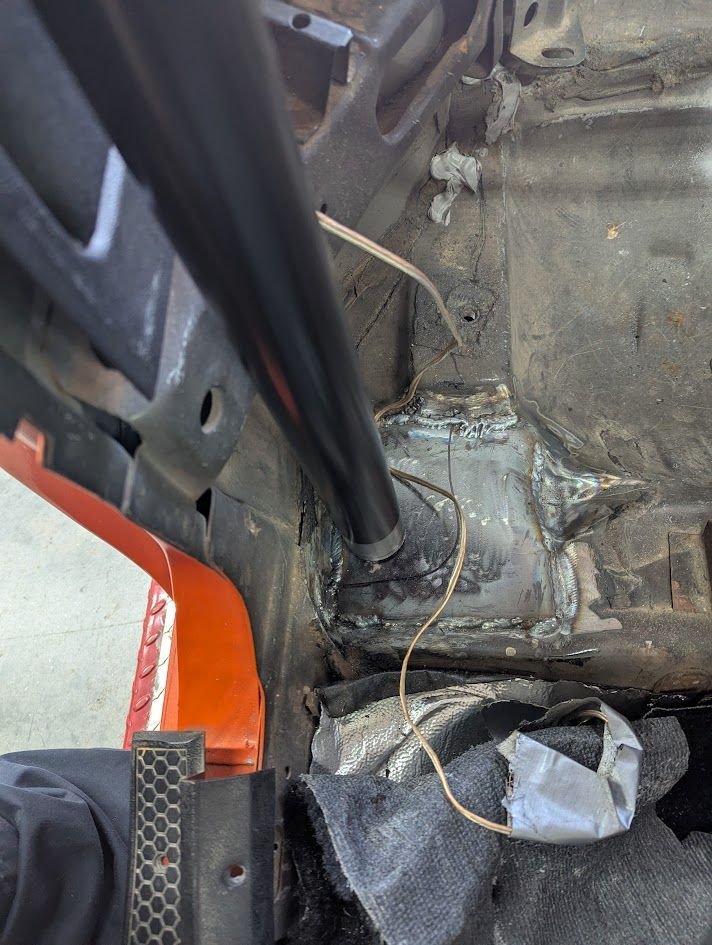

installed 6pt cage TIG welded. pics inside
finnally getting the car done. just tig welded a 6pt comp engineering roll cage. its really an 8pt but im not putting the door bars in until i kno it wont be a daily driver. cage is 1 3/4"x1.34 DOM tubing, tig welded at all joints and tig welded to the 6"X6" 1/8" thick steel plates. plates are mig welded to the floor etc. all in all it wasnt that bad to install, took about 4 days with painting. massaging the 6"x6" 1/8" still plates without a torch was a pain in the A$$!!! i think it came out good. hoop plates are directly over the rear stock subframes and are welded right to them. the rear bars are welded to the rear shock mounts which is the strongest point(just wack it wit a hammer ull see) thats the strongest part to the rear subframe, most ppl just weld them farth back but thats just thin sheet metal not the thick shock mount steel. the pass side rear bar had to be moved up since the cars have that super thin metal support that mimicks the contor of the rear cargo area, in reality its only 22 gauge stamped steel just spot welded so the carpet fits flush... so its not strong at all.
the tunnel mounted bars have been placed there for a reason, i just installed a jegster tunnel mount tq arm and the tunnel mount is 1/8" thick steel brace that bolts to the tranny tunnel from underneith. this brace is strong and spreads the load evenly over the thin tranny tunnel metal. i went a step farther and welded the plates so the last 2 bolts of the tunnel brace go through the cage plates and sandwich the cage plates to the tunnel metal and then the jegster tunnel brace undernieth. this should increase the ridgity of the tq arm/tq arm mount brace as well as the strength of the cage. and tranny tunnel.
the cage is then painted with POR-15. the car floor is blue bc the car used to be blue... now black. also the seams and stock subframes have been stitch welded under the car as well as the rear shock tower mounts (can see in pics) for more strength. rear stock subframes have also been stitch welded to floor for increased strength. i had already installed custom thru floor subframes that can be seen in the pics.
let me kno what u think!! im happy wit it. its really solid

Looks STRONG man STRONG.....nice job on the plates and the placements of the bars, very nice.

I'm hoping you meant to say MIG welded. Those welds look huge for TIG welding.

lol thanks guys, u smack the cage and theres nothing i love it!. um im in northern new jersey. still i have a custom STB brace to fab up with my 383 HSR outa 1.5"x0.95" DOM tubing when i get the motor done. i just TIG welded the strut towers all the way around and welded all the seems in the enge bay and mean all of them lol. i love TIG welding! no smoke or spatter its amazing. i got no probs doin sum work for you
stephen 87 iroc... yea they are big bc i did 2 passes on the welds. i did my research and was told to weld the first pass to get the most penetration/strength and then weld again for increased rigidy etc. these welds are acutally not big at all my cam kinda blew them up. this was also done on my 130amp chicago electric TIG thats about the size of a ghost busters lunch box lol and with only about 3 weeks tig welding experience with just messing around. still tho i had sum ppl look at it and they said it was good, they were impressed with the "roll of dimes" welds i had at every joint

well id say its not the best looking TIG work but hey if it is strong then o well good job!!! Youll get better I love TIG welding they say that tig welders are the artists of the welding world and its the only artistic thing i can do lol....keep up the good work...

thanks, wat would should the tig weld look like on a .134" thick cage anyway? got any pics? i was welding and adding metal for best penetration, then sum extra metal for strength at the weld. i was also making a larger weld puddle so the welds would be a bit beefer.

Nice cage overall, the welds aren't the best but they def. look strong enough. TIG is my favorite form of welding too, I like those little suitcase welders. Give yourself a year and you'll be welding alum. and titanium with ease. Later.

Just curious are you cleaning the painted surfaces before you weld? You should have a 1/2" to an inch of bare metal cleaned around the weld for a nice clean bead. Looks like some of the beads are just contaminated with paint or other things.

BMR sales.... i actually did grind the paint off about 2" worth... thats what u see around the welds, thats not reflection... thats the grinding wheel to take off the paint for a better weld. also grinded the 1/4" bar down to a bevel edge so i weld for more strength. welds are ok was alil difficult to get around them tho and it shows

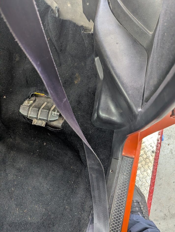

@customblackbird
I know you've since cut the bar out, but did you ever take photos with the interior back in?
I've got everything mocked up, and I don't see how to get the plastic side panels in without cutting them up and it looking like crap.

Yea, but if u look in my thread my hoop was further forward and didn’t interfere with the plastics. Yours is right smack in the middle of that side panel.
i drew a yellow circle where mine was in your pic.
Hmm.. yeah I see that now. I just wanted to get the hoop as far back from the seat as legal so I don't strike my head on it while on the street without a helmet. Hmm.

Not too bad. U can cut up the plastic then if you want it to look better maybe make a molded fiberglass cover that molds it into the plastic and paint to match. You got a good bit more room than I had but it was enough with racing seats which are thinner. I’m 6’1” and I fit with the hoop at least 6” further forward than you.
