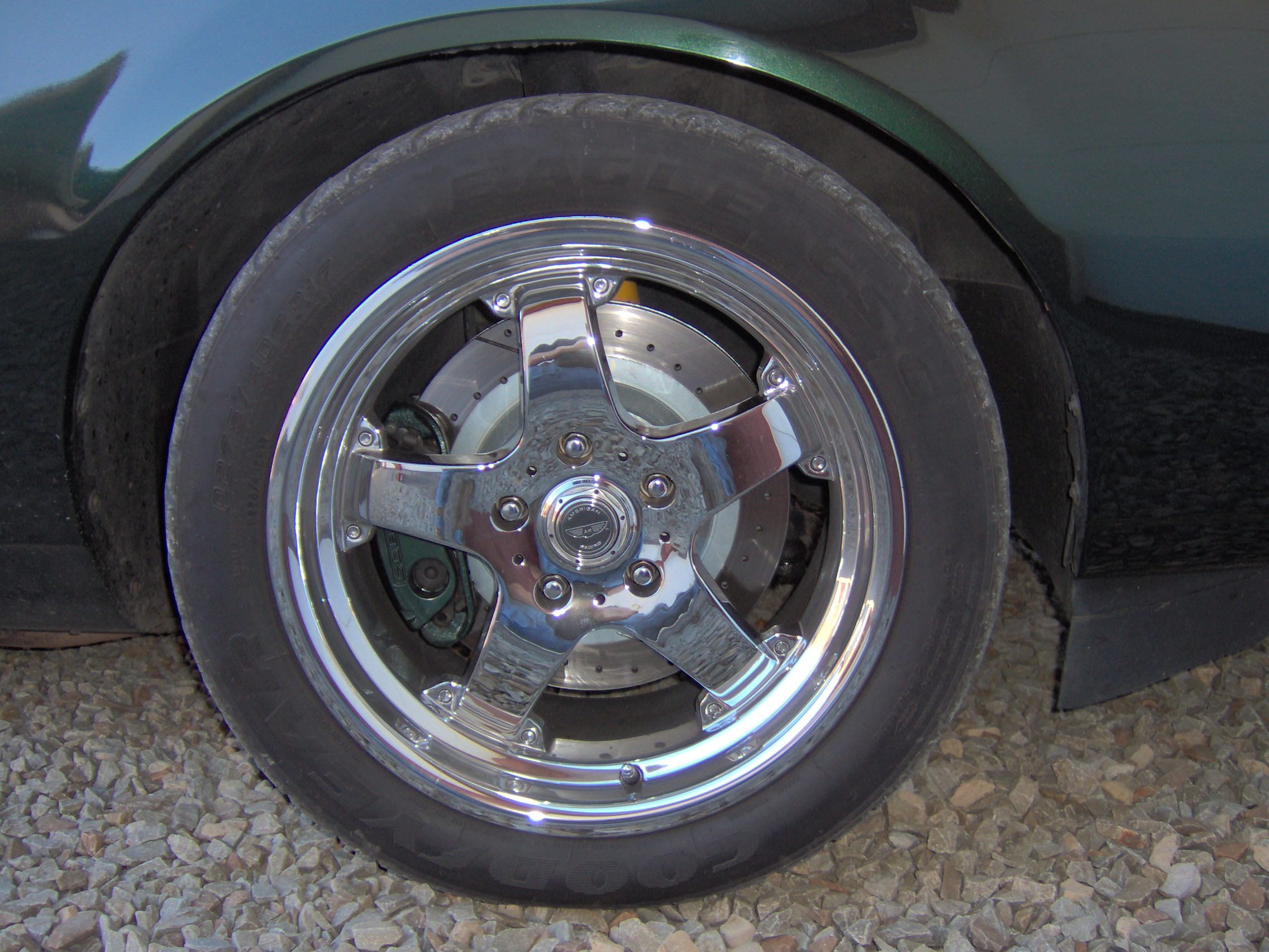

16x8 16lb wheels & 245/255 tires.....
vs
17x9 24lb wheels & 275/285 tires.....
Which would be better? More footprint or less weight?

If youre not trying to shave 1/10ths of a second of track times (road or drag) then just get the wider heavier wheels. More grip with more tire for spirited street driving and the occasional track run will be just fine!

The 275/40-17's were one of the best things I did to my car. 285's are a little big for a 9" wheel.

Most prefer the added foot print over the added weight. My 17s weight like 21lbs while my 16s are somewhere between 17 and 19. Just try to find some lighter 17s. GM wheels (real, GMs not repros) are lighter than aftermarket in most cases. Unless you want to spend it out the rear on some Volks, CCWs, or the like (think 16x8 or less weight for 17x9s). Hope this helps.

Your car is growing/evolving and it needs new shoes. I wish I could afford a set of 17x9.5 snypers... Oh well.

Here is what i can provide....
I run a 17x9 w/ a 6"BS & a 9/16" spacer on the front. They tuck rather well & barely clear the tie rod, but I've driven them for 3 years this way.
Recently added C4HD front brakes which allowed me to reduce the spacer to an approx 1/8 spacer. (using the factory rear spacer)
I went from a 16" G-force to a 17" Nitto 555 & felt an improvement. According to the above comments it should have worsened with a cheaper lower profile tire.
This is a street car, but it is pushed hard enough to test everything from understeer to throttle induced oversteer. The 17's gave me a better feel & I could better predict when it was about to come unglued, plus I picked up corner speed.
Now with a set of 800/150's & Konis & Strano rear bar, it fascinates me to the point that I want to see how I can improve it more. It is only slightly loose to the point that it will slide all 4 tires with just slightly more rotation of the rear.
Went to a 1/2" spacer on the rear tires & it seemed to slightly help it out.

Wait a sec.....
I have 17" x 9" with 4 1/2" bs on all 4 corners. Doing the math, your effective bs is 5 7/16". That would be IMPOSSIBLE on mine....Yet somehow, YOU did it?
I can't even fit an open ended wrench between the tie rod & the rim. If I had 4 3/4" I would be IN tie tie rod. 5 7/16" & I would be on the other side, THROUGH the tie rod end.
So...I'm ROYALLY CONFUSED by yours.....Please tell....HOW?

Re: Width vs weight....
Stephen,
You are using math to determine backspace based on offest.... Place a straight edge across the wheel & measure to where it touches the mounting face on the back side of the wheel. This is the correct way to measure backspace which takes in to account the bead thickness as well.
Depending on the wheel manufacture & the inner shape/dimension on the actual wheel it can vary a little depending on how sharp the radius is on the inner edge near the tie rod. Many run a 5.5" BS wheel without problem.
This is the wheel (AR Rebel 17x9 24mm offset) which has a 5.94" BS... you can verify it on American Racings website.
Stephen,
This is the wheel which has a 6" BS... you can verify it on American Racings website.
By that method, which is not the TRUE method (just easier for people to understand) the bead seat is not counted. Just tire seat to seat surface. INSIDE the beads.
THIS is the TRUE wheel width. It is just easier for people to understand surface to surface.
Coker Tire
By your account, my 17" x 9" are 10" wide,surface to surface. I think the manufacturer knows best. But even with your method, that would only equal a 5" bs. 5.5" would NEVER fit.
No....I AM NOT MISLEADING PEOPLE! YOU ARE!!!!!
For YEARS & YEARS & YEARS, the measurement has been at the TIRE BEAD SEAT. As I showed in the site link. I guess YOU did not look? I even supplied the pic, for those too lazy & stubborn to click on links themselves.
The wheel manufacturers, as of late, have given up on EDUCATING people, such as yourself, which regards to WHERE to measure backspacing.
It is just EASIER to explain..."Take a ruler...Measure..,There's your backspacing.", to people like yourself. Instead of EXPLAINING to them, that the TRUE place to measure, is at the TIRE SEAT SURFACE.
ROH themselves, my rim manufacturer, will tell you (i have personally emailed them to ask, and your welcome to also)...The ORIGINAL (not the ones that fit 4th gens) 17" x 9" Snypers for 3rd gens (that did not require spacer/adapters) are a 4.5" backspacing/0mm offset. I guess you are saying they don't know how to make their own wheels?
Attached you will see...Even by YOUR measuring method (which is wrong), they are exactly 5", to the edge. I don't have 1/2" between the edge & the toe rod. IT WOULD NOT FIT.
Before you suggest that my measurement clearly shows it to be above the 5" mark, notice that the #s are just to the left, or below in this orientation, on the ruler. The 5" line is RIGHT AT THE cross bar measuring point, which is on the edge of the rim, which is you you suggest the measurement be taken at.
I can explain this all day, but if you are not willing to learn the TRUTH, and are swayed by modern interpretation, then there isn't much I can do to educate you.
You know.....I'm wondering WHY I care so much about YOUR misinformation.....I guess I'm only gonna post, because I already typed all this & took pics for you....

I can't believe how MY THREAD has degraded ito this STUPID "discussion".
It is a FACT, that measuring the way YA'LL want to measure wheels, has CHANGED in modern times. How many times do I have to repeat that?
It's people like me (and apparently ROH) are the ones not wanting to "go with the flow" and change to everybody else's new way of measuring....Whatever....I'll just measure thing for ya'll, so that I don't hafta explain the TRUTH anymore............
So yeah...My 9" wide wheels have 5" of backspacing, yet a 0mm offset......
