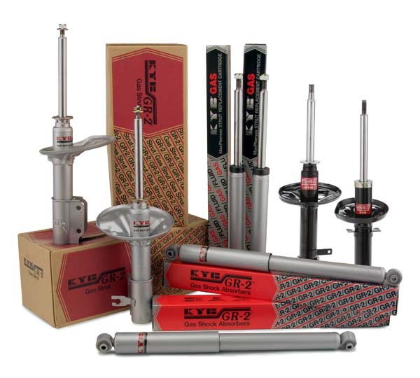

This pic shows what the mount looks like. Do they really have these mounts on them?
http://www.tirerack.com/images/suspe...yb_group_l.jpg
As far as my car plans go, I suppose you can say I want to take it into the 12 sec bracket, but keep it a street car. It is my DD afterall. It won't see any track time, maybe just to make sure it does break into the 12's, but never a road course.
They shouldn't, none of those struts even look like they are for our cars.
