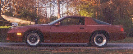

Hi guys,
Ive got 9 x 18" fronts with 10 x 18" rears with 265/40 x18" tires all round
check out
www.lintonbros.ic24.net/car1.jpg
cheers
powermite
