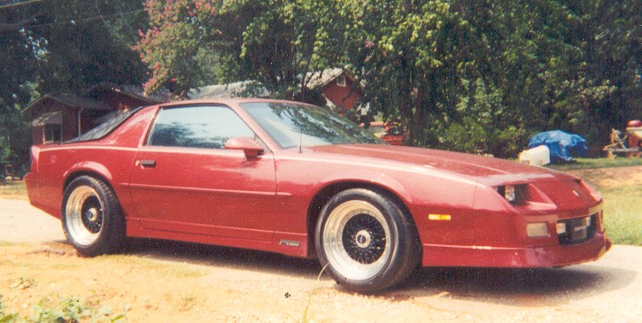

My fronts have 4" BS and the rears have a 6.5" , which I really wouldn't recommend to anyone unless you don't mind doing quite a bit of clearancing. I actually had to heat the inner fenderwells and actually stretch the sheel metal to fully clearance them. I had to notch the LCA's a little more than 1/2". But as I sit here, I can't make them scrub now. A thirdgen with that much B/S, by all practical means needs to have mini-tubs. But the effort was worth it, because the pictures don't really do the car justice, because the rear tires's section width is a little over 13", and they are just BARELY under the lip of the quarter panel. The front section of both of my wheels are the same offest which looks cool. Here's a recent pic since I lowered the car.
Oh, and BTW, I don't have IROC spring anymore
I lowered it with Hotchkis springs since this post started.
I lowered it with Hotchkis springs since this post started.------------------
