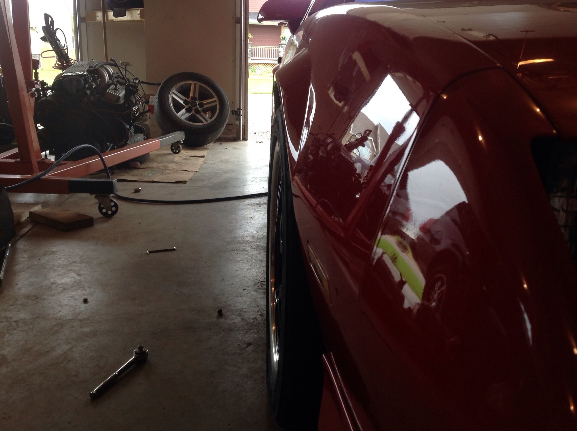

Believe it or not they work front and back without any modifications at all! I tried 2 inch and 1.25" spacers. Both worked without rubbing. The closest point for rubbing is inner fender of the front wheel. I could. It believe that the 1.25" spacer worked. I think it's because the car was lowered that it has the ability to clear the strut. Kind of a bonus for me anyways after installing these tires because they are a little taller than my factories, I gained 1/2" clearance under the car but kept my tight fender to wheel gap. This is good for me because I've been trying to get my lng tube header y pipe to work and that .5" sounds minimal but actually that makes a big difference! I am going to exchange the 1.25" for 1.5" just because the dust cap is only slightly preventing my Center caps on the from rims from clipping in place. Also I think I would like a little more stick out than what I have. Here are some pics of the 2 spacers, 1.25" and 2".

2" spacer
1.25" spacer
2" spacer
1.25" spacer
