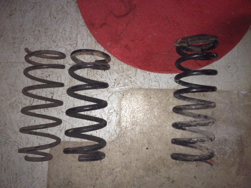

Here's a pic. the "high rate" coils are on the left (left is rear and middle is front) and on the right there is a base model coil.
Drkhrse89 do you remember if yours looked like the ones on the left?

It just depends on what springrate your springs are and how heavy your car is.
I read taht the rear springs are progressive rate, and I used to believe that, but I just see no evidence of that. Anyone have any clairification? Progressive rate springs should have thicker steel or tighter coils as they go down, but our rear springs do not.
Anyway, I cut 1/3 of a coil off my fronts and my rears have been cut different amounts to level out the back of the car. around a half coil on one side and 1/3 coil on the other. The isolaters were removed and replaced with heater hose. Seems to work well. The fronts are a pain and I figured out a way to install them without spring compressors (much safer than spring compressors too) and I still dont like pulling them out. So if you want to risk a 1.5 inch drop, cut em a half coil. If you want to be more conservative, 1/3 coil.

I kept the isolators on the rears and my springs looked exactly like the ones on the left. Like said, I am not going to guess what the rate is now since my cut was not exact and from spring to spring was probably not exact. That will completely change everything. All I can say is it handles really well and is not horribly harsh.

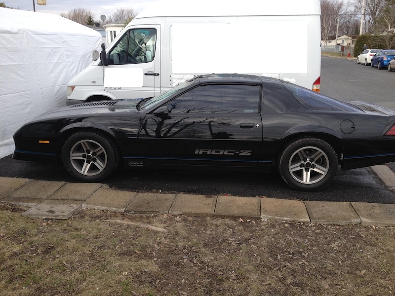

Here's a pic after i cut the springs. I went with 1/3 front and 2/3 rear and i chose to leave the stock isolator's. My front 255's do not rub eather.
