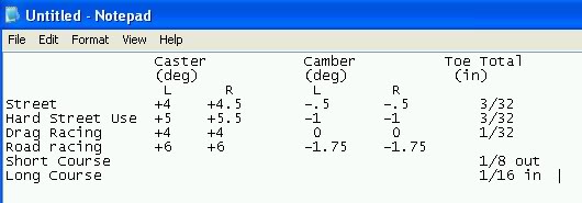

Im rebuilding my entire front end next weekend and want to get an alignment done with these specs. Name:  alignment.jpg
Just wondering if the stock upper strut mounts can handle the hard street caster settings.

Some cars can; not all.
The majority will make it to "street".
You can lengthen the slots with a wiz wheel. Of course this may lead to other problems (tires rubbing the fender wells near the door), but that's another matter besides "is it possible".

i ordered strut mounts from founders. Well see how it goes
