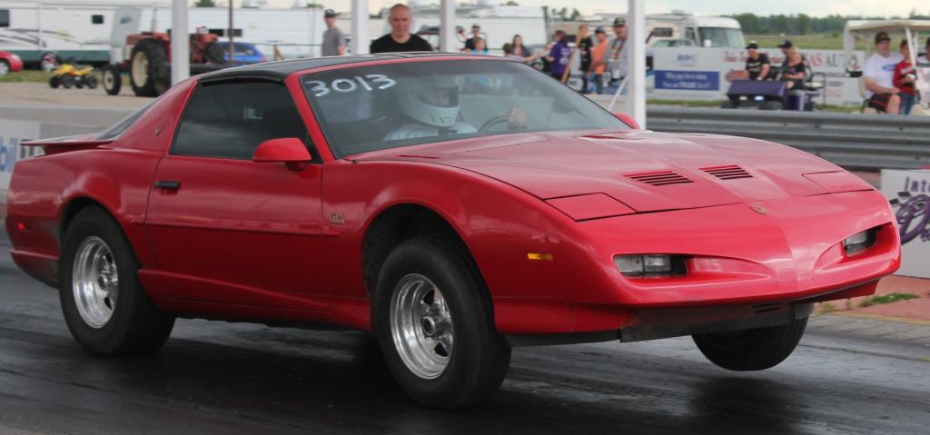

i was looking at your pic Ziggy. see how your front end lifts a bit? mine is dead flat.
that pic is not the best representation of how a car should launch. that was with a completely stock suspension on a very well prepped track with my first 383. the rear does more squatting then the front does lifting.
but on another note you said you cant move your front end at all. that's bad you want the front to be able to move for weight transfer on the launch.

Drag radials don't always need a burnout. Not all drag radials are the same, some are not meant to EVER see street use, just made to qualify for a class. Some are designed for every day street use and track. Check it out.
http://www.stangtv.com/tech-stories/...-drag-radials/

well, i barely beat the muffstain by a car or 2.
sure made my day. hes got a t-56 and aluminum heads. i was surprised that i won. says hes buying a new shortblock now, lol.
he did some big smokey burnout first, so i heated mine some. it seemed to help.
but my front end is still dead flat. after i change a few things, i'll post my results.

If your running street tires, 25psi is still too much. I run anywhere from 12-18 on my chevelle at the track, that's the only way to hook it on street tires. You can stagger the air pressure to help it launch straight. Even with posi, 2 or three psi more in the left would make it out. usually a bigger spread with an open diff.

so heres what i messed with;
i put coilspring expanders on the front, cause i had them laying around. i know, dont scold me, but i had to see. i expanded the springs about 1". guess what? my front end moves up and down now.
next we unloosed the sway bar end links about 1" of thread.
now the front end moves up and down decent, but the rear looks lower.
its seems to hook much better.
so although some silly ideas, adjustments, i'm leaning towards the car needs new springs.
i might try raising the rear a tad just to see if it helps? might be time for 4 springs?
