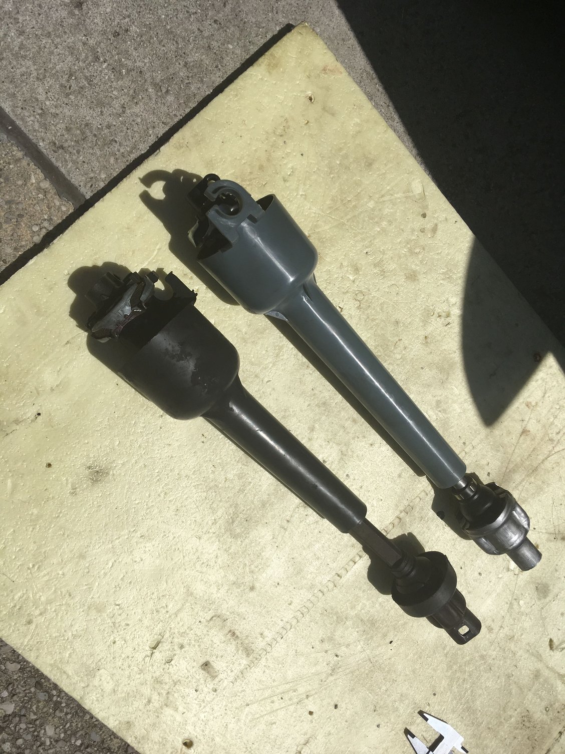

Thanks to 66chevelle66 on ebay (hes a user here also i believe) i got an astro shaft, and another dude on ebay a 2000 transam shaft. If I can get a machine shop to take the astro ujoint off and weld on the transam ujoint, then it should bolt right in, no notch needed.
Attached Thumbnails Any issues with the astro steering shaft-img_0013.jpg   Any issues with the astro steering shaft-img_0014.jpg

Well i have quite a lot to tell you...
First i ordered a brand new OEM steering shaft for a 82-92 camaro...
https://www.ebay.com/itm/1982-92-F-B...0AAOSw6VRaBhzU
and steering column bearing upgrade
https://www.ebay.com/itm/1969-95-GM-...72.m2749.l2649
I finnaly got parts and was so happy to install them but...
First i went to install the bearing upgrade...And it just fits soo loose, the bearing isn't fixed into the plastic cup...but instead it moves a lot. The bearing actually doesnt do any work, inside part of it its fixed on to the shaft like its supposed to be but the outside isnt fixed it turns and moves in the plastic cup... Seller said there seems to be something wrong with it and he will send me another one...but in this time i wait i will just make another plastic bushing to be a nice tight fit.
Here is the video of "upgraded" bearing kit :/
Next thing is the shaft...omg... The fitting at the end its about 2 mm bigger than the original one and ofcourse you cant tighten it enough on the column, it has lots of play... I tried to narrow it in the vice but it doesn't go much and it will probably just become egg shapped... Very bad copy... The rag joint setup also looks so cheap and the plastic shroud is longer and because of that harder to install... for this price i was expecting a bit more quality part. Ofcourse it says on it "Made in Taiwan"... Seller refunded me full price for the item so i am fine with that.
Original shaft and new replacement together.
Original shaft says 19 mm opening
Replacment says 21 mm
So i am back with the astro shaft, i put some nice snug rubber hose on it and its a lot better with the noise...
