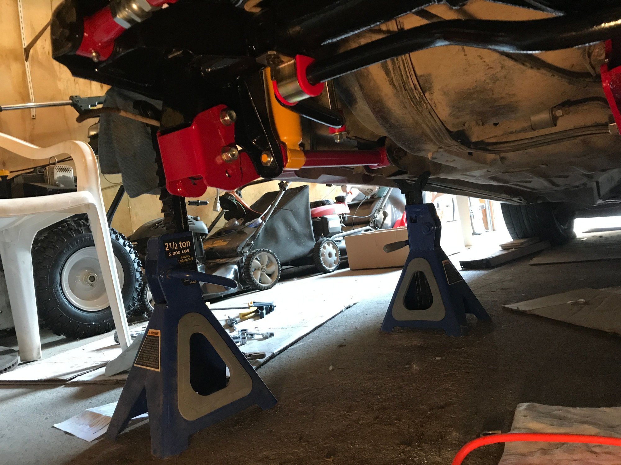

Well I got that stubborn torque arm mount finished up tonight. Was easy just removing the tail shaft. Minimal fluid lost as well. I'll top it up when she's on the ground again. Rear end is sitting back in place and founders lcarb in. Still lots to do but I'm in no hurry and loving every night I get to spend on it.
Oh man i love that feeling! Same reason why i try to take my time, so i can enjoy it

Well I got about as much done as I can till more parts show up. Just waiting on brake pads and seals and I can get the rear end back together.
Factory caliper didn't look too pretty
Dressed up the old iron caliper. Bad system, but I've had enough spending money. Lol
Rear end all finished for now
The rest needs a pressure washing now.

You should have received longer 100mm bolts for the relocation brackets. Make sure you use them so the nylon part of the locking nut engages.

One too that helps with iron calipers it's to apply foot brake then apply parking brake hard as you can then release for brake then parking brake last. That seemed to be the best way to keep the pads tight to the rotors so the brakes work decent. The later PBR LT1 or LS1 brakes are an easy swap when your budget recovers

Cool thanks for the tip on the brakes, I've been a little worried about them from what I've read. And ya nothing was torqued there just yet, that's why it looked like that, I did that last night. Thanks for looking out though.
