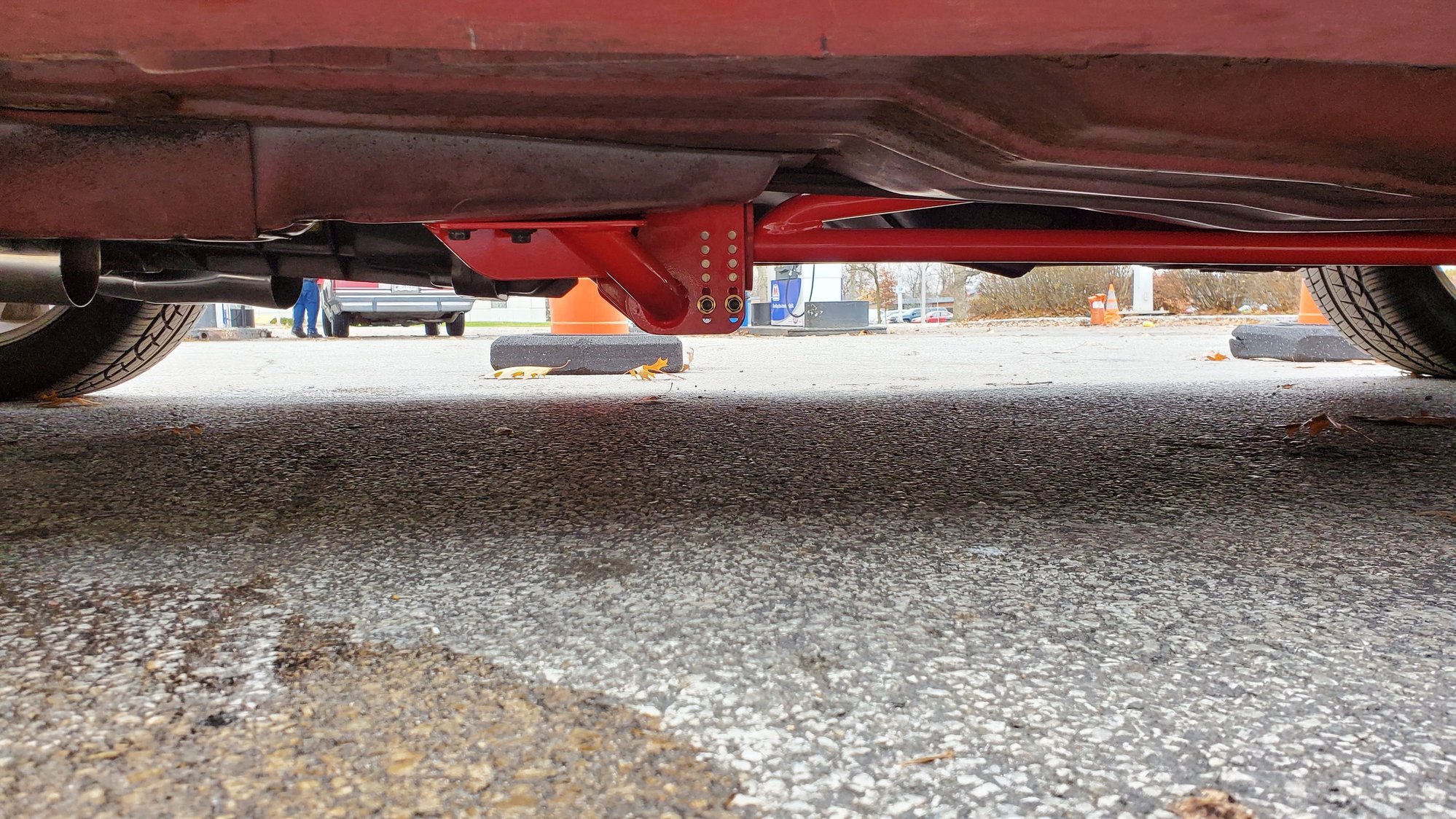

Was wondering how much ground clearance you all had that are running this Crossmember. I have 3.5 to 4 inches of clearance at a stock ride height and just wanted to see what others were running and if you had any scraping issues? Not running yet but seemed pretty low to me.

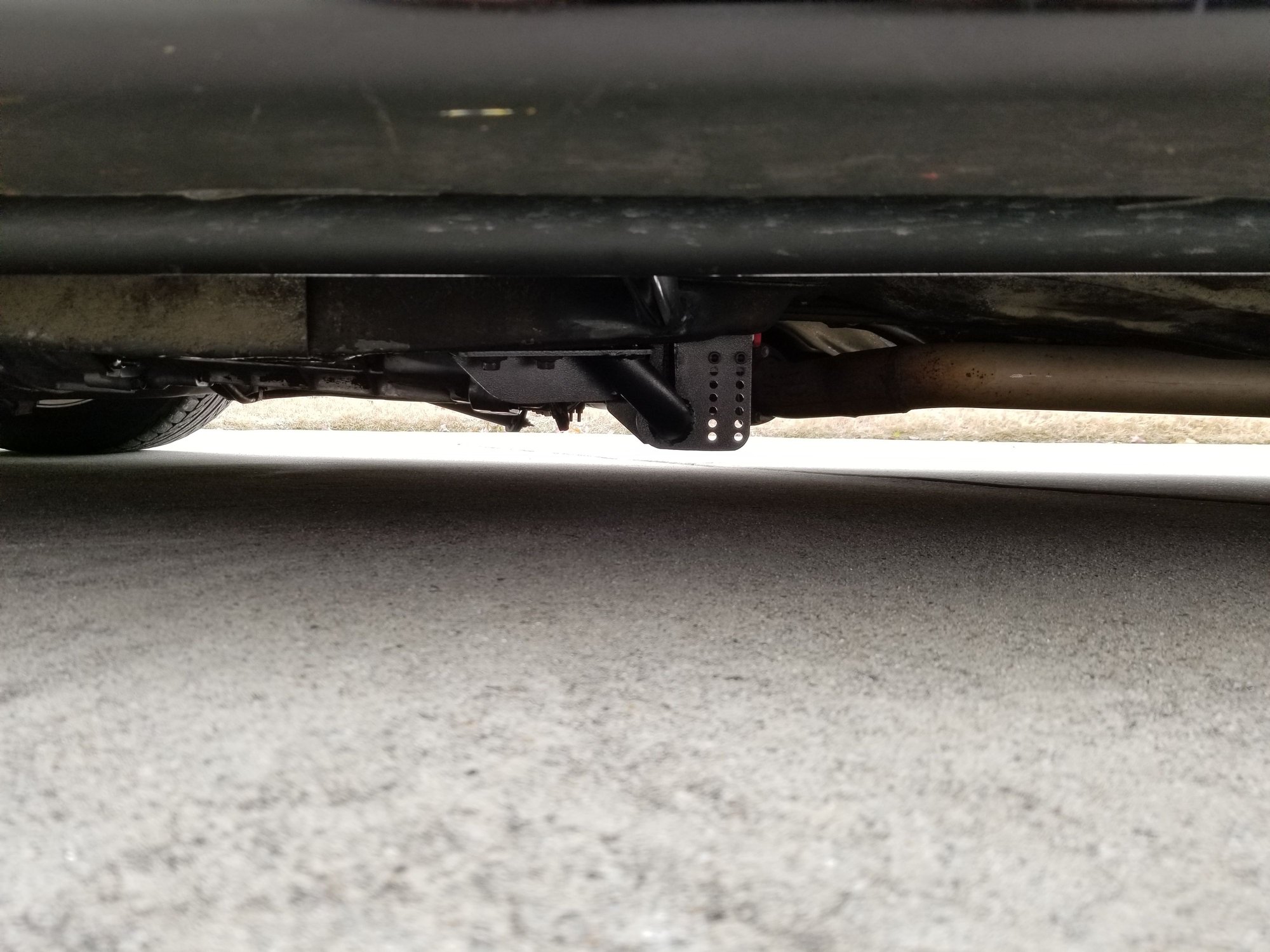

Got a shot today. Any recommendations for something that sits up higher?
