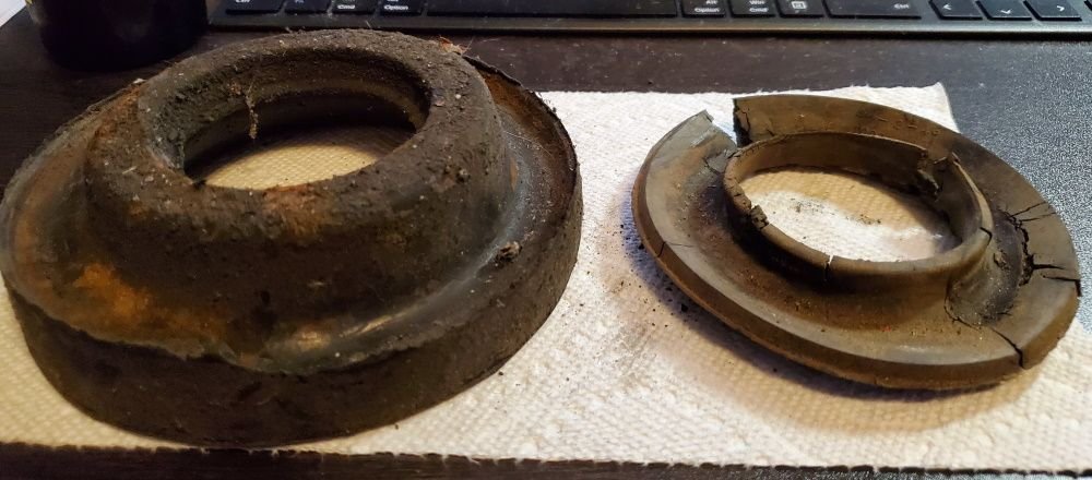

I bought a 1992 camaro z28 a few months ago and am slowly fixing it up (didn't run and needs lots of work). The rear springs are Hotchkis 19930016. I'm looking to replace the rubber isolators (upper and lower). I believe these are the original isolators. Anyone know where I can purchase replacements?

The top are original, the bottom aren't. There wasn't anything between the springs and perches from the factory.
Heater hose + razor blade is about the only game in town.

Slice it lengthwise, slip it over the coil, tape or zip tie to retain. In all honesty, the uppers have probably been in that condition for 20 years and are still doing the job the were designed to do in that condition.

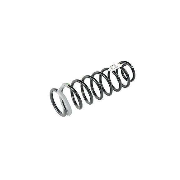

Im giving these a try on my car. If you know anyone doing a lift kit on the new 2018 and up jeep JL wrangler, they have these grey rubbery plastic isolater's on the factory springs. Its kinda the same thing as cutting the hose, but its already split and made the right size. Theyre working so far on my car. Not sure how long theyll last, but i didnt spend any money on them and thought id give em a try.

interesting I would of thought the rubber isolator would have started at the first coil from the bottom not the second coil. I suppose that’s so the spring can slip onto the perch with out any issues as the isolator might prevent it from fitting. You could probably get the isolators from mopar parts I would imagine also but likely at a premium over heater hose.

If you like the current height, clean & reinstall the uppers.
Toss the lowers.
If you want the car lower, replace the upper with a piece of heater hose.
Be sure to orient the springs the same way with respect to the lower perch so height is same side to side.
No need to spend money on unnecessary stuff.

Cleaned the uppers already and waiting for my heater hose. Thanks!

The heater hose goes in place of the upper if you wish to lower the car some.
Do not use both.
Nothing goes on the lower side.
