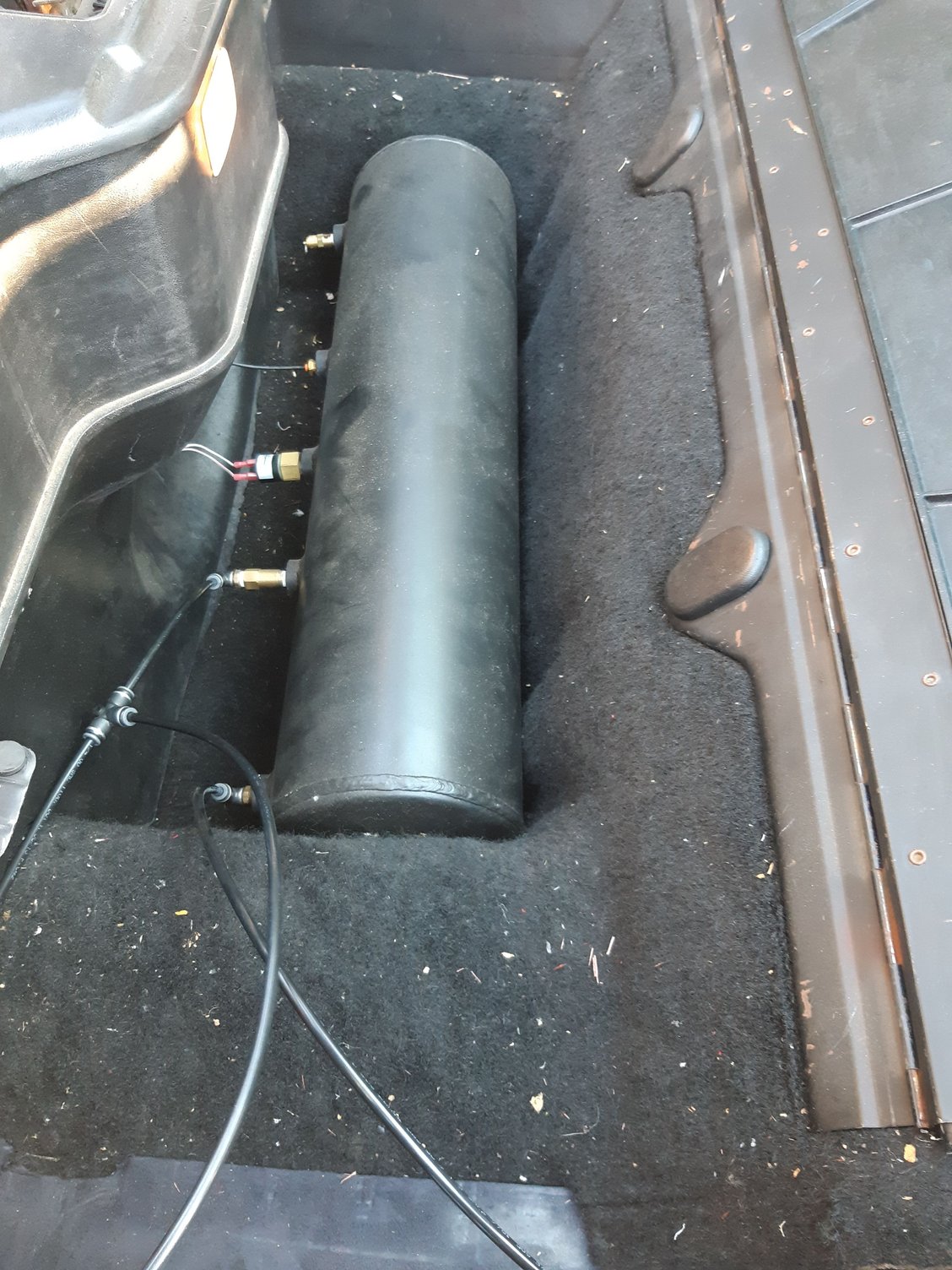

I have my compressors and the valve body in the spare tire area but my tank (it's a 5 gallon) i had no choice to put in the foot well since there's no way I could fit it in either the spare tire or storage box areas in on the sides. my subs are in a box in the back-seat area with the seat folded down. No one sits in the back seat anyway.

The 5 gallon tank

Originally Posted by MeenZ28
The 5 gallon tank
Compressors and valve body
I didn't think you could fit a 5 gallon there. Looking at your pic I would still be able to fit subwoofers on a board across the back even with a tank at the bottom. I guess I'll shove my 4 gallon down there at the bottom and use the face ports. Did you drill a hole at the bottom of the floor for the drain?

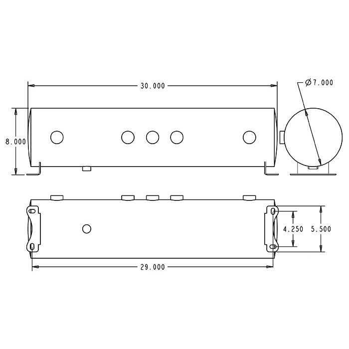

Do you remember the dimensions of your 5 gallon tank?

Right from Ridetech's website.
