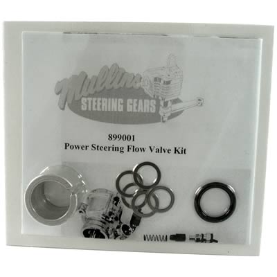

You can get the Borgeson shim kit for GM pumps. I also had the problem of the steering box feeling "over-assisted". This shim kit reduces the hydraulic pressure reaching the steering box, requiring more effort by the driver.
On mine, three shims seemed to do the trick. Really nice kit, comes with detailed instructions and special tool to get the job done.
https://www.summitracing.com/parts/brg-899001

Thanks ULTM, this is very interesting. How difficult is this to install? Do you have to access the steering box?

You just need to pull out the valve assy. Remove the high pressure hose from the back of the pump. Then grab that hex and remove the valve assy.
No need to remove the pump itself. And you don't touch the steering box.

Borgeson makes a kit and a member has used it to modify the pump to lower the pressure and increase effort. So I am guessing youre guess is wrong.
Just ordered the kit, will see how it goes.
