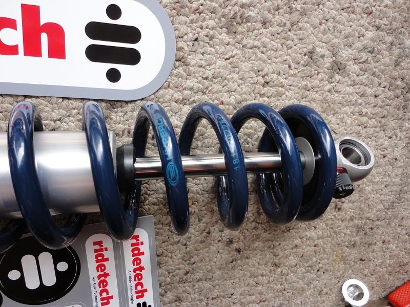

The Quick Answers:
JRI is the best racing shock. In my experience JRI racing shocks provide more tire grip than any other shock made. The only two cons are price & that they need to be rebuilt with seals sooner. That’s a minor thing when winning performance is the goal. The Ridetech shocks provide the best grip of what I consider to be street shocks. The level of grip, while greater than any other street shock I have experienced, is not in the same league as JRI race shock grip. One is a race shock & the other is a street shock. Unless something damages the shock, the Ridetechs will not need to be rebuilt with new seals for a long, long time.
Both are very tunable & responsive to tuning changes. Both can be valved with “linear/digressive”, “digressive/linear” & “high-zero-number” valving curves. Those traits are key to achieving the secret sauce valving I do to achieve the most grip possible from the shocks. The JRI shocks will accept significantly stiffer “high-zero-number” valving while still being responsive & maintaining grip. With the JRI shocks, we can tie the front end down longer … for longer corners. This is not an issue for autocross, but does come into play for road courses. For this reason, I supply Ridetech Triple Adjustable shocks (with my special valving) standard on my AutoX-Star front suspensions. For my Track-Star front suspensions, JRI double adjustable shocks (with my special valving) are standard.
When I first started exploring the PT scene, I saw that Ridetech was very popular and didn't really know why, as I had not heard of them in the racing world I came from. Over the last year, I've gotten to look at a lot of shock valving curves from almost all of the PT Shock manufacturers. After some dyno testing & revalving Ridetech shocks of our own, the picture got clear. There are many factors that define the actual real world handling & ride characteristics of a shock. The dyno curve is one of them. It’s an important one, but just one of several factors.
The factors that matter most to the ride & handling are:
1. Piston design - defines the valving curves possible, responsiveness,
2. Piston seal & friction - self explanatory
3. Bleed valving - controls the initial shock responsiveness control
4. Valving control – in most cases a stack of special shims that deflect & define the oil flow through the piston
5. Adjustability range - To tune or adjust for very different situations like track & street
6. Rebound & compression bleed over - how much does one adjustment affect the other valving
7. Body & overall shock design – affects how it manages the pressure, control & responsiveness
8. Stiction (from piston seal & shock bore surface) = pressure required to get the shock to initially respond
9. Internal rod/shaft pressure - affects initial shock responsiveness
Old Nov 23, 2020 | 06:25 PM
TEDSgrad's Avatar
Joined: Sep 2010
Posts: 1,627
Likes: 47
From: Double Bratville
Car: '89 Formula
Engine: LS2
Transmission: 4L65E
Axle/Gears: MW 3.42 12 Bolt
Re: Rear Coil Overs
I’m sure I left some things out, but you get the idea. Items 1, 2, 3, 4 play the biggest role in the valving curve. Items 5 & 6 define the range & accuracy of tuning. Items 7-9 define how well the shock can keep the tire gripping the asphalt over irregular surfaces.
Other things matter too, like ...
• Is it rebuildable?
• Is it revalvable?
• Parts availability?
• Tech support?
• Customer service?
• Warranty?
• Return/repair policy?
• And lastly initial purchase price & TCO ... total cost of operation.
What I learned about the Ridetech shock … and I hope I’m not sharing any of their trade secrets … are:
a. By running larger bleed valve orifices
b. Combined with stiffer main valving from the piston & shim stack
c. Inside an extremely well designed shock
d. Provides the best balance of ride comfort over irregular surfaces & bumps … and handling control with heavy cars in cornering situations.
Other perks or benefits of their design are:
e. Wide range of effective adjustability
f. Very low pressure bleed over
g. Fully rebuildable
h. Easy to revalve for different curves
I have experienced good parts availability, tech support & customer service. Since I don’t own a set of Ridetech shocks on a street car, I can not personally vouch for the million mile warranty or their return/repair policy … but I hear great things from their customers. Where the rubber meets the road for most guys is initial purchase price. I am super impressed with how much shock you get for your money. In my opinion, the Ridetech shocks are the best shock in their price range by far. Nothing that costs the same as the Ridetech shocks can compare to the quality & performance of this shock. It is a heck of a value.
Most people … not all … but most, do not look at TCO (Total Cost of Operation). They should, but don’t always think past getting their baby running. When we factor in the million mile warranty and you realize you won’t ever need to replace these shocks. After years of use, if the shocks fail, just have Ridetech rebuild them. So the initial cost is the total cost … well … wow.
I have revalved many Ridetech shocks with my “secret sauce” valving to achieve what I call “Autox Valving” & "Mean AutoX Valving". On Lance Hamilton’s 85 Monte Carlo SS Shocks with “Autox Valving”, we can tune the valving to be a good AutoX performer … kicking butt on an amazing list of C6 Vettes, WRX’s & other cars … and the wide adjustability range allows the shocks to be adjusted back to great street ride. In other cars we have shocks with “Mean Autox Valving” we make the “zero-number” rebound valving higher for competition purposes and the ride can be adjusted back to “pretty good” for the street, but not as well as Ridetech is famous for. This second version is for cars that see less street time & are more concerned with winning events. I was blown away at how well these shocks perform on the autocross track with my “secret sauce” mean race valving.
Do I feel Ridetech are the best shocks available at any price? No. I hope I don’t hurt anyone’s feelings, but there are a true racing shocks out there that are going to perform better on track, autocross or road course. High end racing shocks cost more ... often a lot more ... and in higher levels of competition where winning competitive events is king, these racing shocks will be a better choice for racing or all out track & competitive event performance. I feel Ridetech shocks are best at providing a balance of street ride, handling & durability … and occasional AutoX or track day. They offer the closest handling to a race shock without having a race shock.
