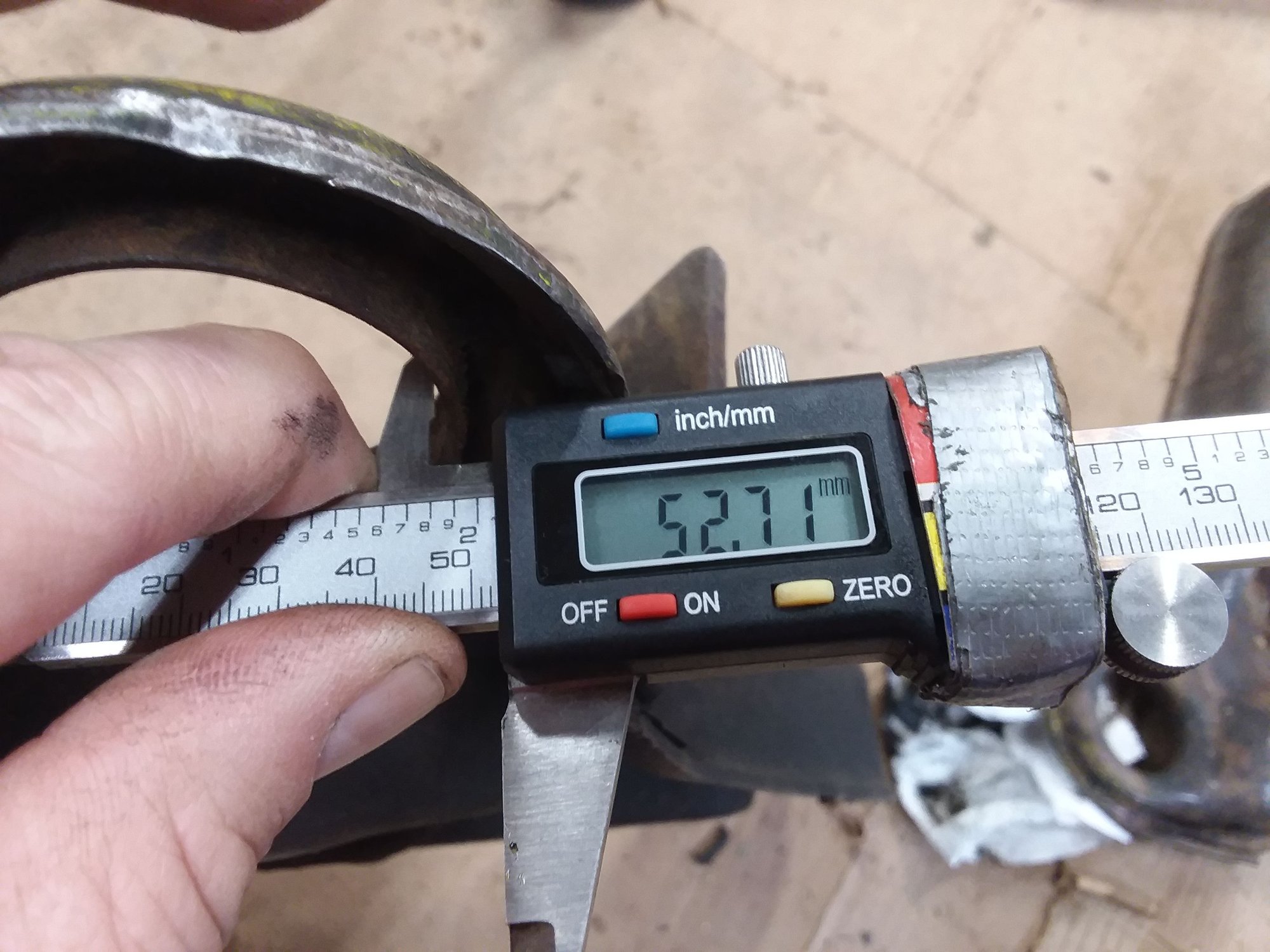

I dug the old ball joind out of the scrap barrel, and measured it:
Here's the new Moog ball joint, which appears to be the same size:

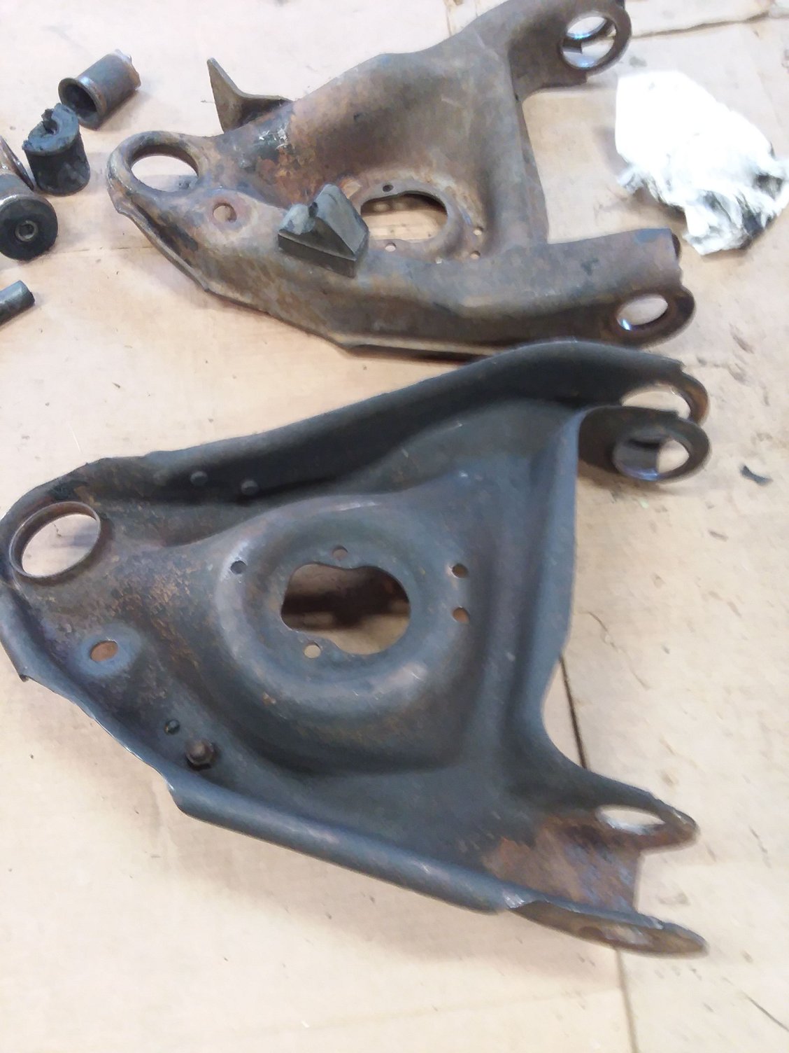

And here's the control arm:
When things dry out a bit, if they ever do, I'll hit the boneyard and grab another pair of control arms. I'm not surprised they have been swapped out. My parts car is swiss-cheese rusted all over, but appears to have had a long-term owner who really took care of it, mechanically. Came with a pile of documentation, and plenty of notes written in various places under the hood.

In your first picture, you show the new balljoint installed only up until the knurling starts. The knurl gets pressed all the way into the control arm. Not sure if the pic was before or after you checked the fitment.
With .35mm (.013”) interference fit, that should be plenty for a press fit.
Old Jan 9, 2021 | 07:08 PM
NoEmissions84TA's Avatar
Joined: Feb 2017
Posts: 4,185
Likes: 576
From: Meriden, CT 06451
Re: New Ball Joints too small for factory A-arms
Yeah, 53.06 mm in a 52.71 mm hole. That says press-fit to me.
Notice that the MOOG part says "problem solver", whatever that might mean.
