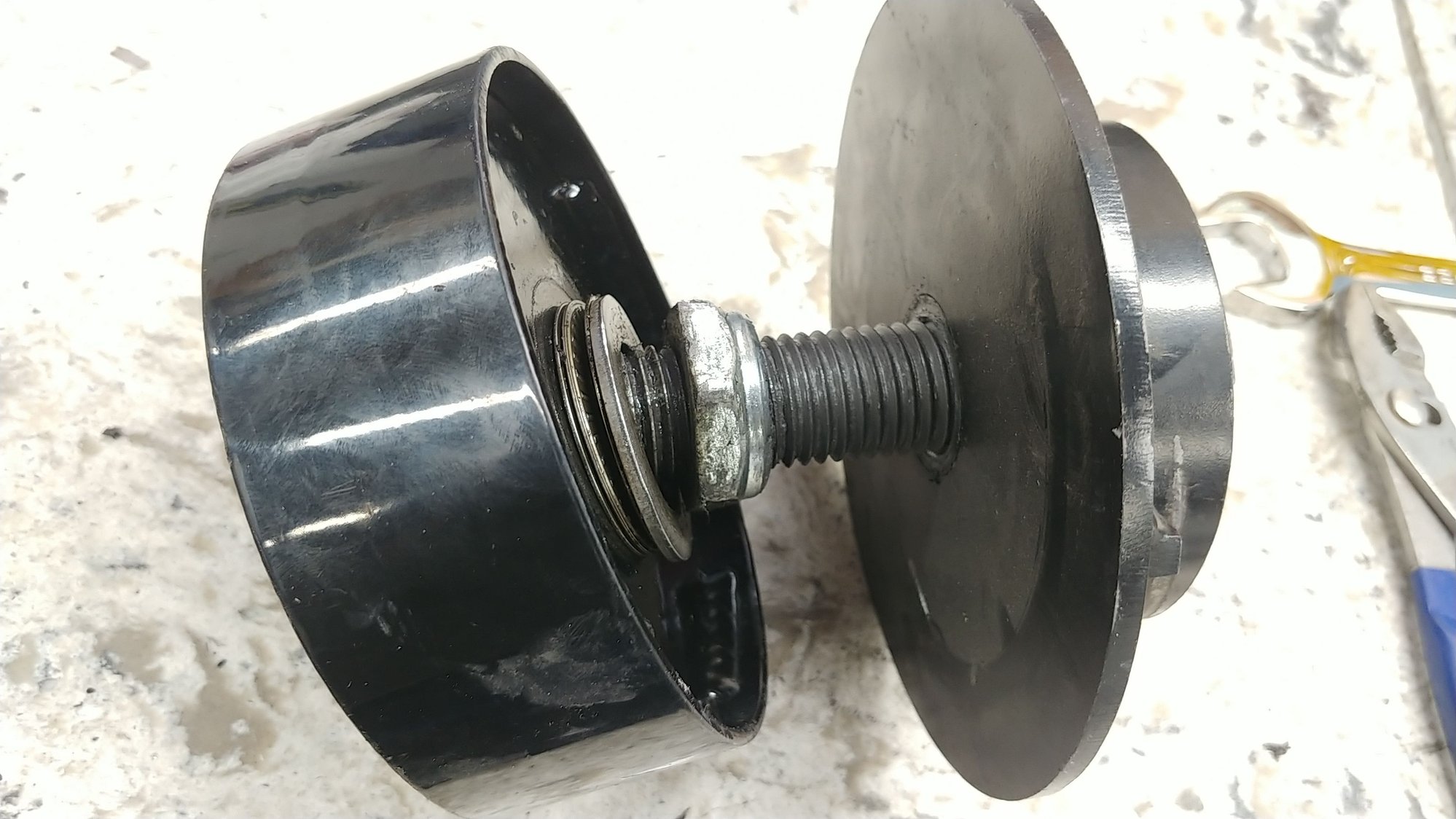

1. wobbly thrust bearing (see video)
the washers used have a smaller I.D and won't allow the thrust bearings to be tightened further, eventually like mine, they started clunking and wobbling.
the rear jacks wobble in the same way and make a TON of noise, but I don't have a tool to reach the nut on the rear jacks.
since i'm converting to PENSKE coil-overs, i'll leave the rear jacks as is

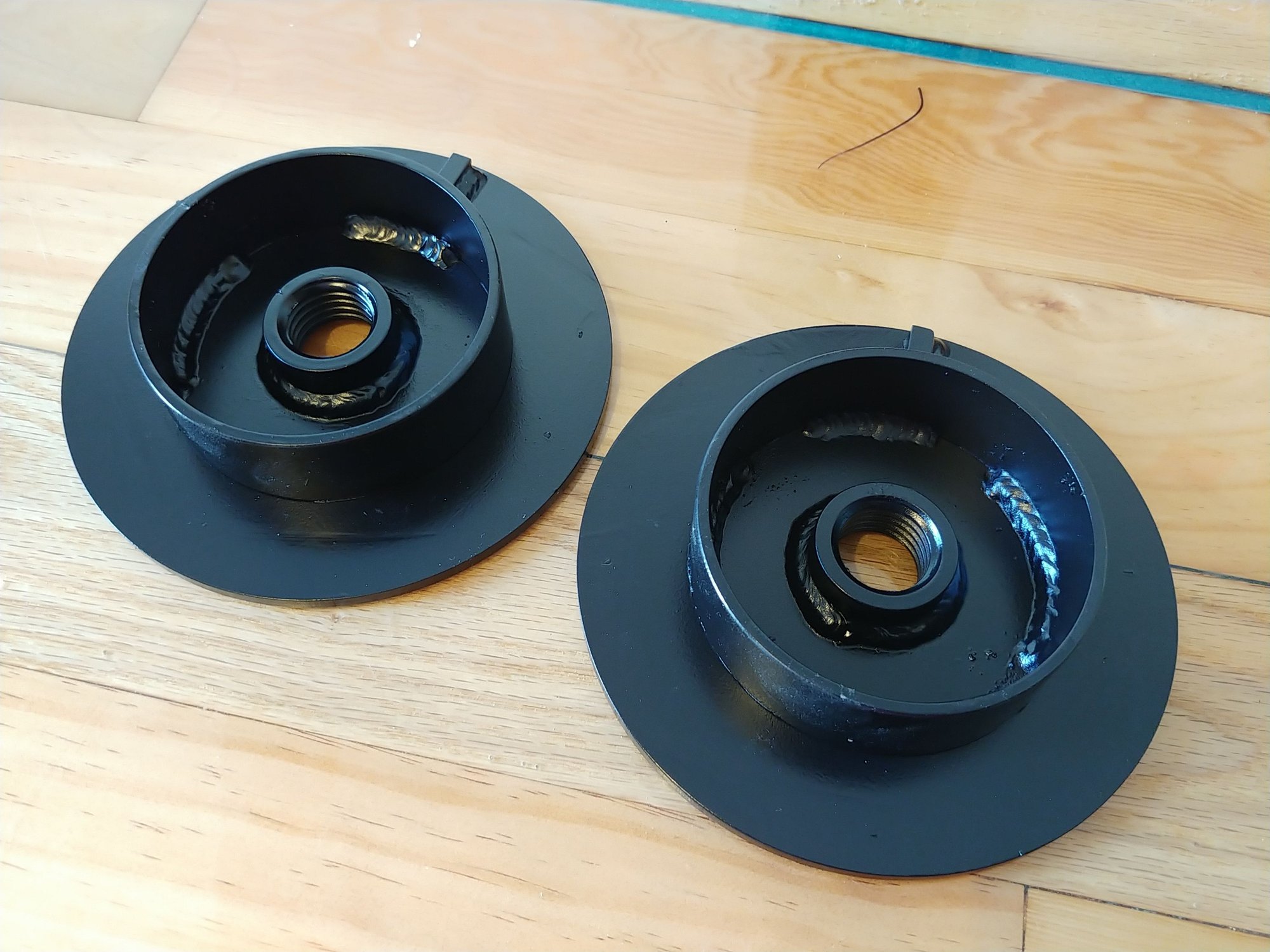

2. A bent bottom plate with a cracking weld---
somewhere along the line UMI changed the weight jack metal thicknesses from 1/4in to a thinner 3/16in
and stopped welding 100% of the circumference. The weight-jacks are now thinner with just 2 stitch welds.
Over time the area between the welds were bending and peeling away at the 2 stitch welds.
This was primarily on the front driver side weight-jack
The passenger weight-jack was bent a little but not enough to start cracking welds.
I forgot to take pic of the damaged driver side weight-Jack and I had already welded up the cracking/gap
pic is the non damaged passenger side for reference
the fix was welding 2 more stitch welds to the jacks where UMI excluded them
a few minutes and a TIG welder made short work of it
my brother media blasted them and a few coats of POR-15 chassis paint brought them back to life.
so if you are an avid racer, make sure to keep this in consideration as a possible inspection point for failure

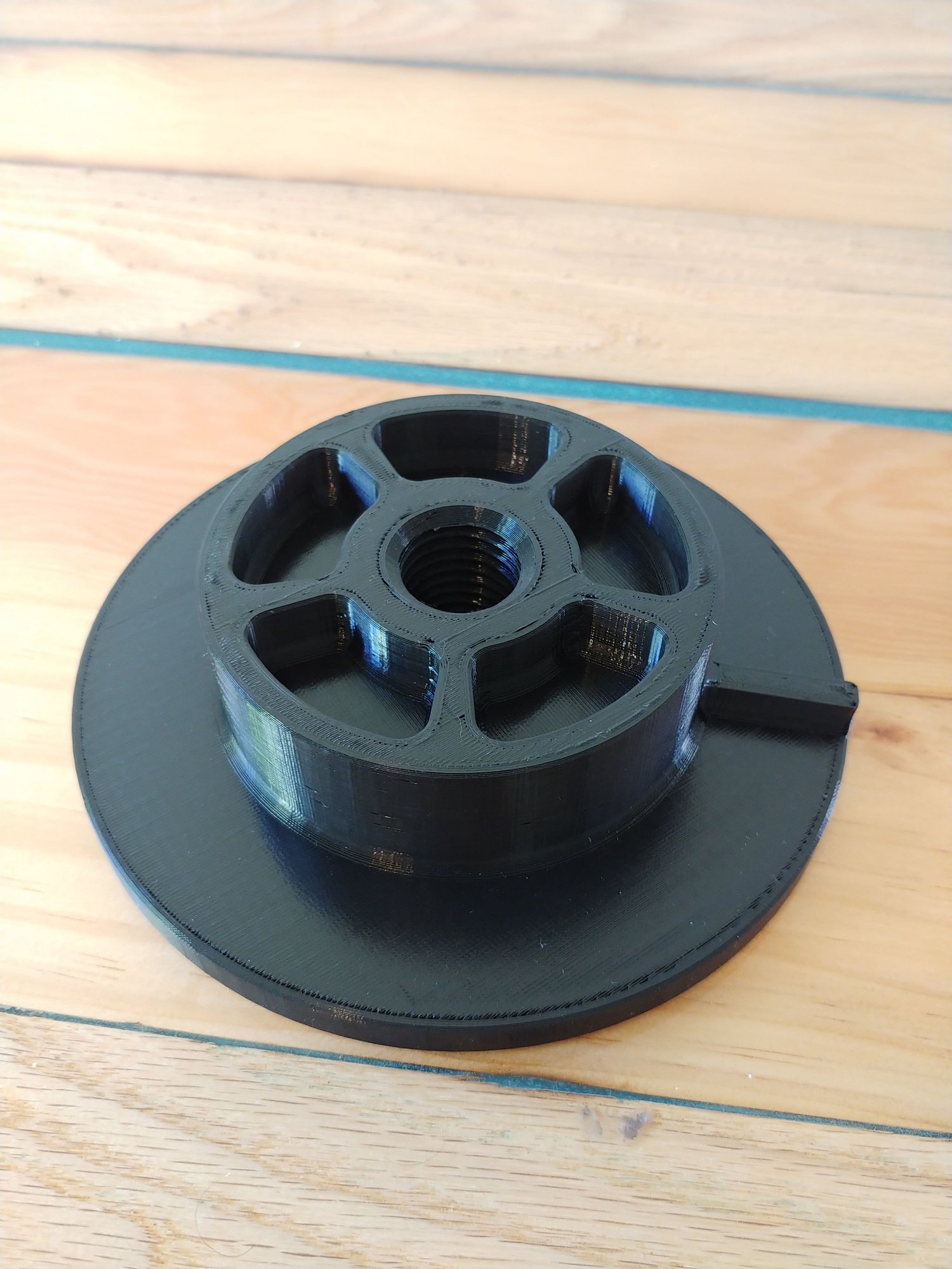

i'm gonna try to make some Billet weight-jacks of my own design to avoid any further potential issues
2 stitch welds instead of the 4 it needs
This is the undamaged passenger side, but this is where the split was happening.
Extra 2 stitch welds added for a total of 4
Blasted after welding
POR-15 Chassis paint and they are good as new
before blasting a quick TIG fillet weld with mild steel filler wire
Billet 6061 Aluminum Prototype
3d printed, still need changes

Re: UMI weight Jack failures
Went to do my yearly Suspension maintenance check.
and found this.
These weight jacks are like a gift that keeps on giving.
-Mod washers and -re torque bearings.
-Then have to Re-Weld the inside of the jack.
-And now coat the 1in-8 threaded rod in red locktight and hope the lock nut doesn't loosen again.
I really need to finalize my Billet weight jack design.
Maybe I can find some aerospace 6AL-4V titanium scrap to use

i don't know what k member you have, but i noticed this new weight jack integrated spring perch that they now have for use with their weight jack... it eliminates one of the components... i had the same UMI weight jack kit on my camaro that blew its ramjet so while swapping that out this winter i changed to this weight jack arrangement as i have their k-member... i haven't had the same issues to date that you have had with the original design, but i liked the way this new design better so i switched... haven't driven it yet
https://www.umiperformance.com/home/...-with-springs/
and found this.
Still not sure what you're doing to these that no one else is to bust them up this bad. We've had ours on the car since the part was introduced after breaking the Ground Control units. We've put close to 4000 autocross laps, 2000 road course miles, and another 8000 street miles on the car since then and nothing has broken or shown any damage on the weight jacks. This is in a 3800 lb car with 1100 lb front springs and a 315/30/18 tire.
