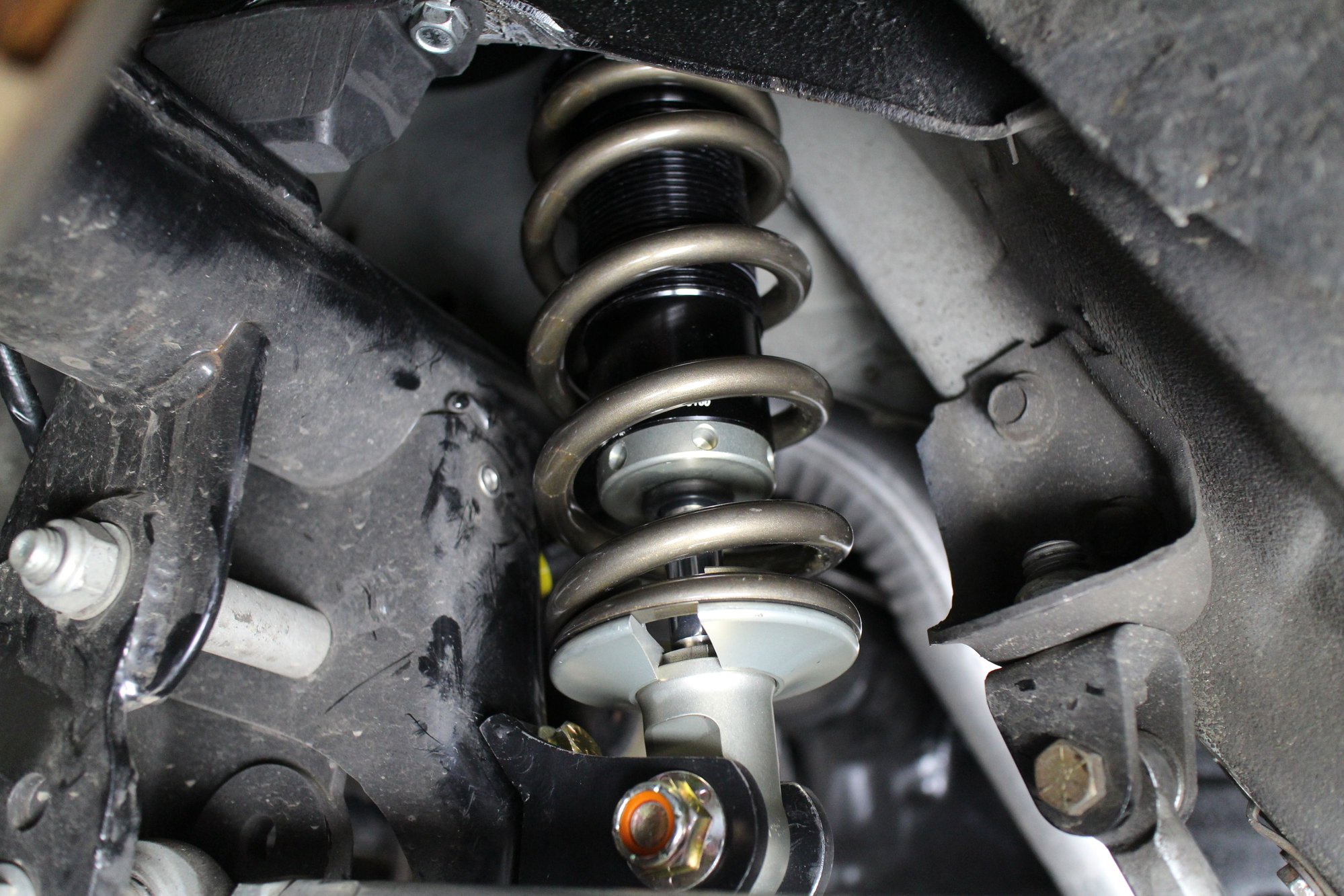

PENSKE 8300 Double adjustable with remote res

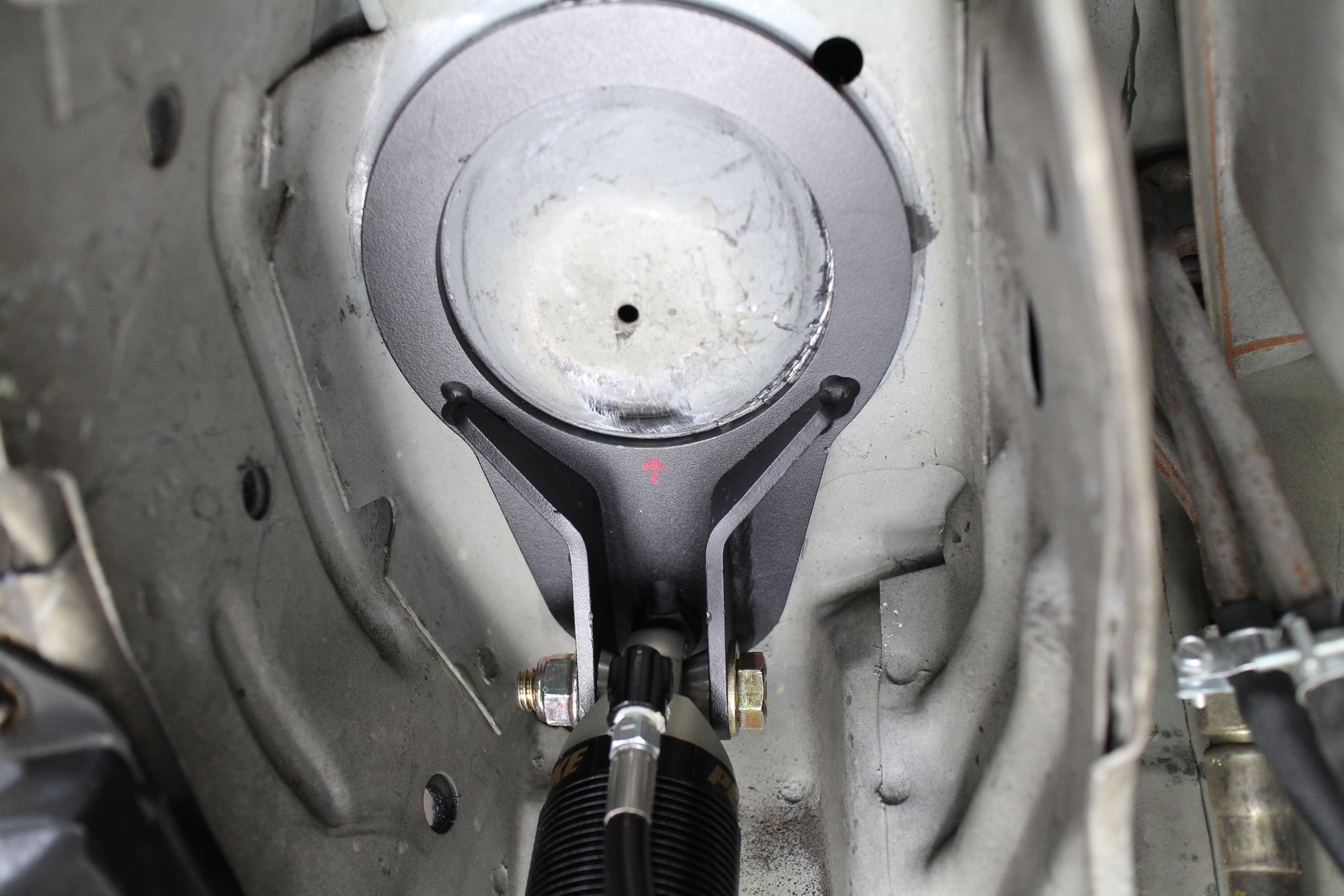

upper Founders coilover mount
installed at full droop

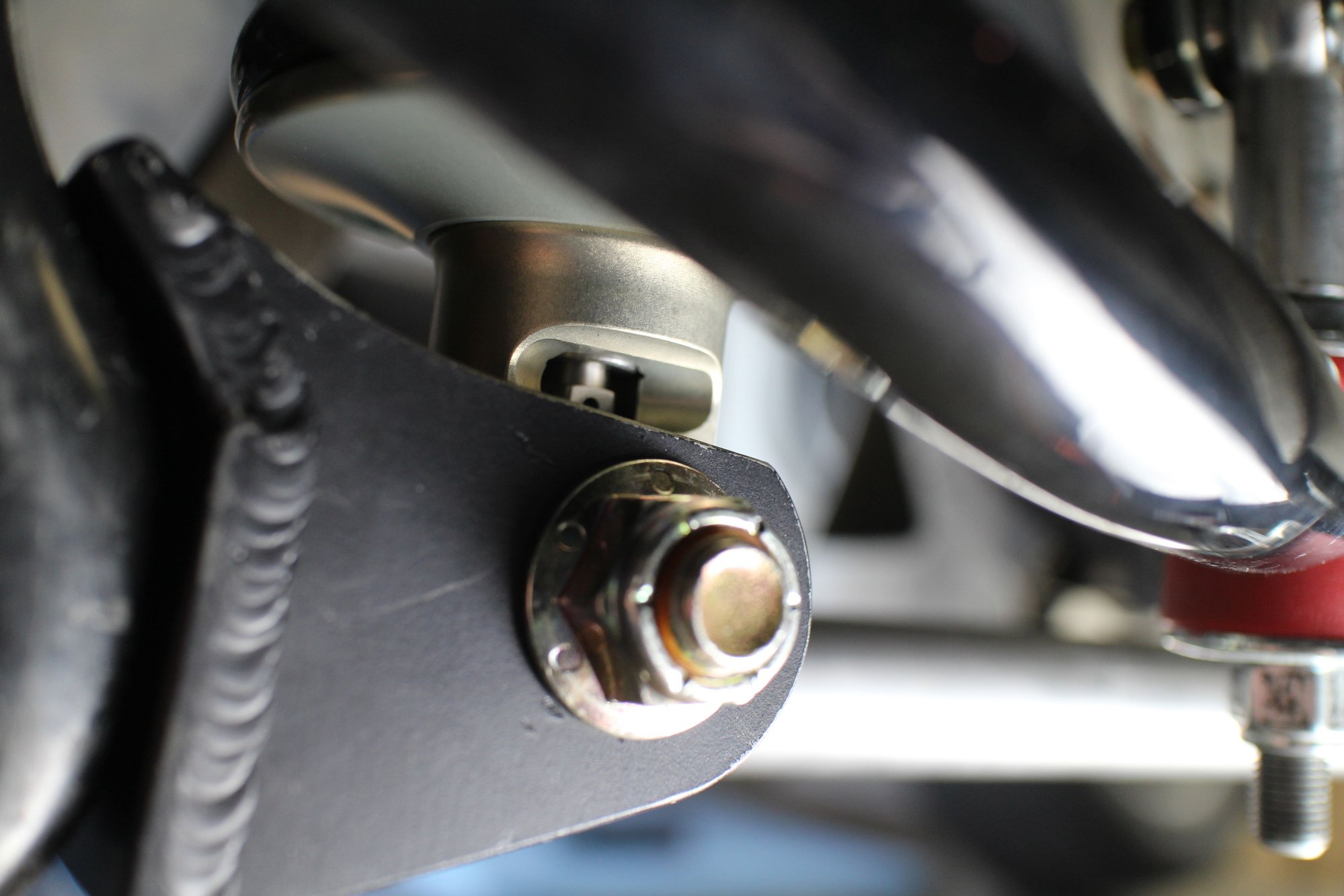

custom 316 stainless rod end spacers machined by a friend
mount allows access to the compression sweep
maxed out on bump stops, still has travel left

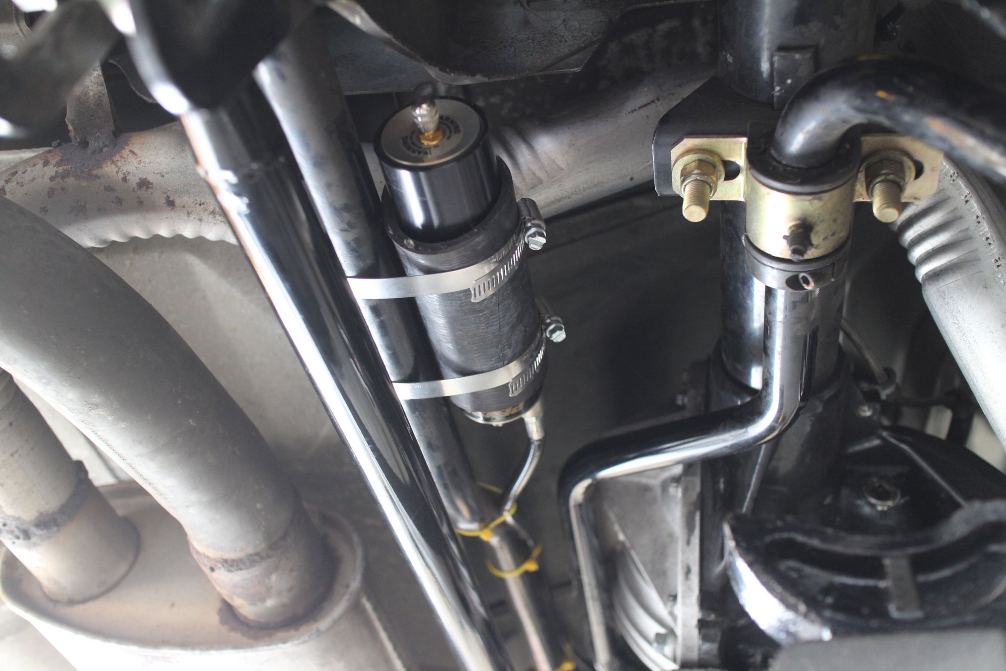

remote canister mounted to the pan-hard Support bar.
routing the remote res lines away from the axle

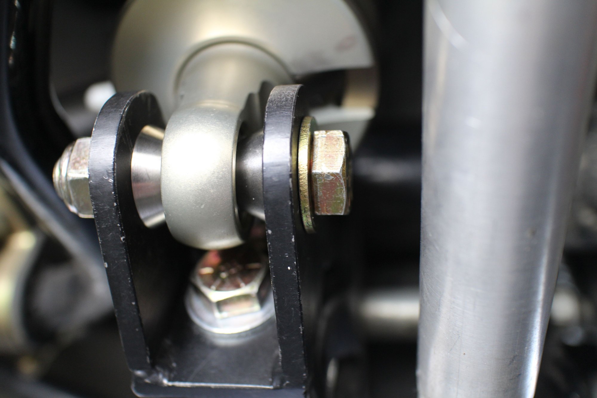

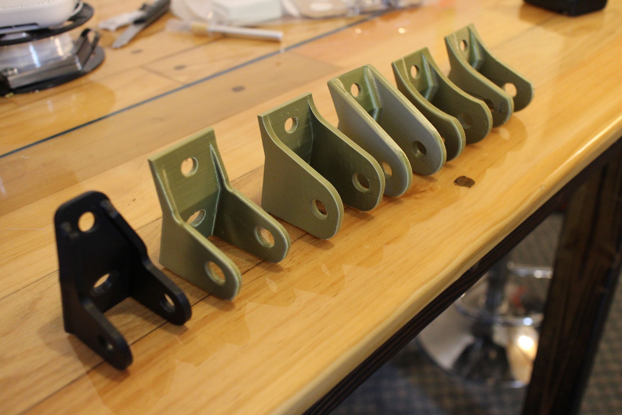

3d printed lower mount prototypes
the Founder's lower mount (left) didn't work, so i designed my own (right)

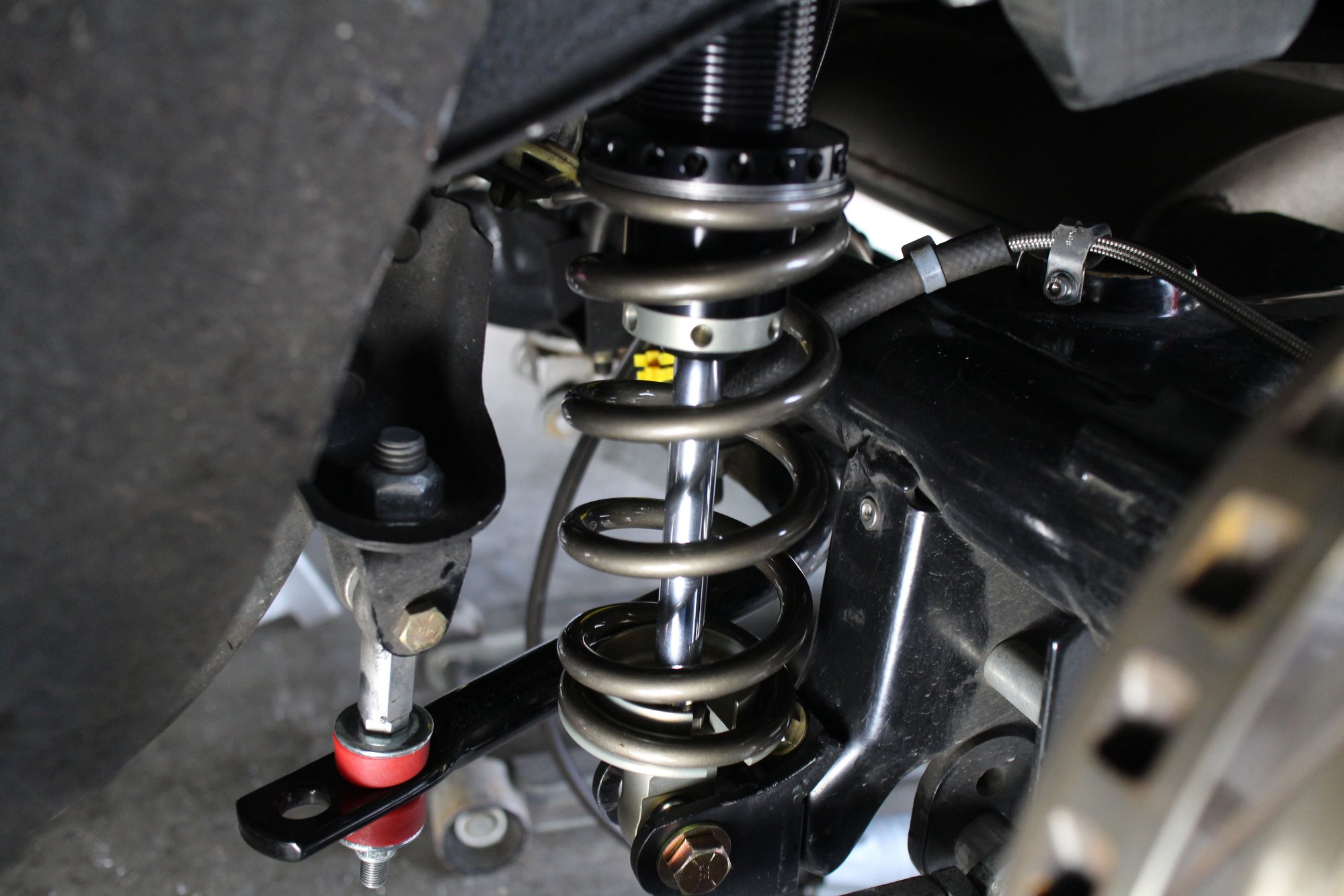

Shock bag t protect the coilover shaft and seals. 100% necessary as rocks and dirt will damage the seals
re-routed PTFE stainless braided brake line
