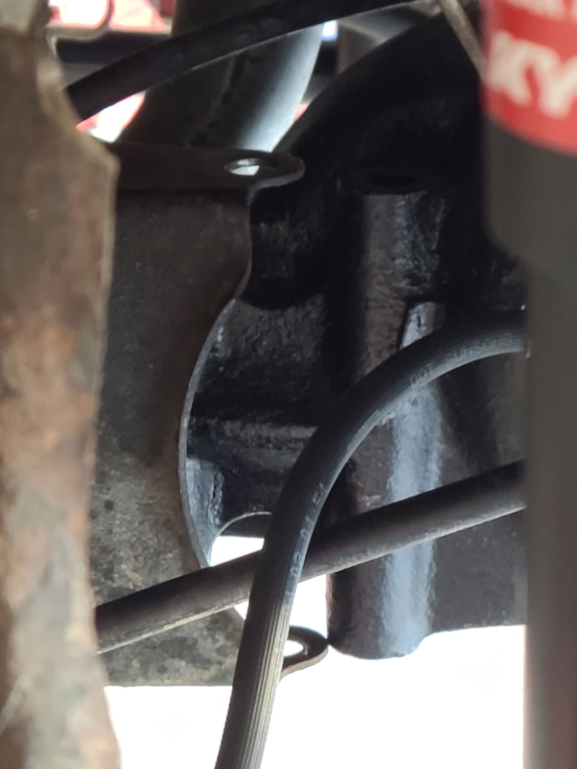

Hoping someone here can help me out. Doing a fourth end rear end swap out of a 99 z28. Have new tubular rear lcas and panhard bar from UMI and everything went on great except for the torque arm. It looks as though the rear end is sitting 1" too far back and the holes won't line up. I have tried jacking the axle up and nothing has helped. Should I remove the lcas and try to bolt the torque arm up and then install them? Any help would greatly appreciated.

Slide it back?
It might be easier to mount the torque arm to the axle, then mount it to the trans.

if you haven't already solved this, It's significantly easier to do the bolts on the axel and then the rubber mount on the transmission.
