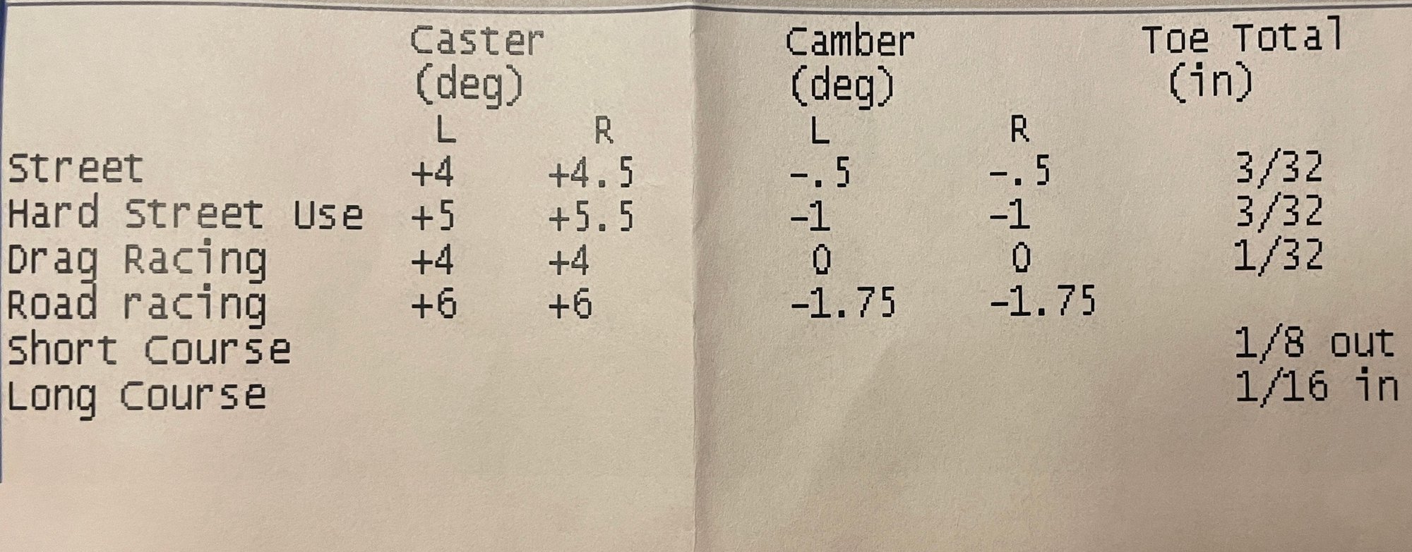

Going off of the alignment specs below what if any would you change using the “Hard street” specs? Car we be driven on the highway what issues would I see with a 1/8” toe out condition?

My car sits at 26.5 thinking about going to 26" this year but want to up the front springs. I use the hard street specs just set the left and right caster the same.

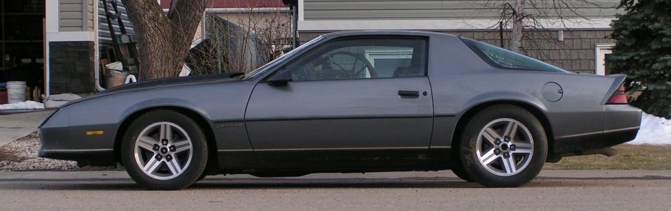

For the record, this is (was) my street/strip Sport Coupe.
Front
Rear
Profile
I also use the hard street specs.
FYI: Factory alignment will absolutely ruin the front tires as the outside edge is burned off in short order.
YMMV.

I currently have my ride height set at 26" in the front and 26 1/2" for the rear. -4.9 degrees of castor, camber is at -.5 degrees and my toe in is -1/16". My car drives awesome with these settings. I do know going toe out will cause your car to wonder more on the road. Any lower on ride height I have clearance issues with my aftermarket exhaust.

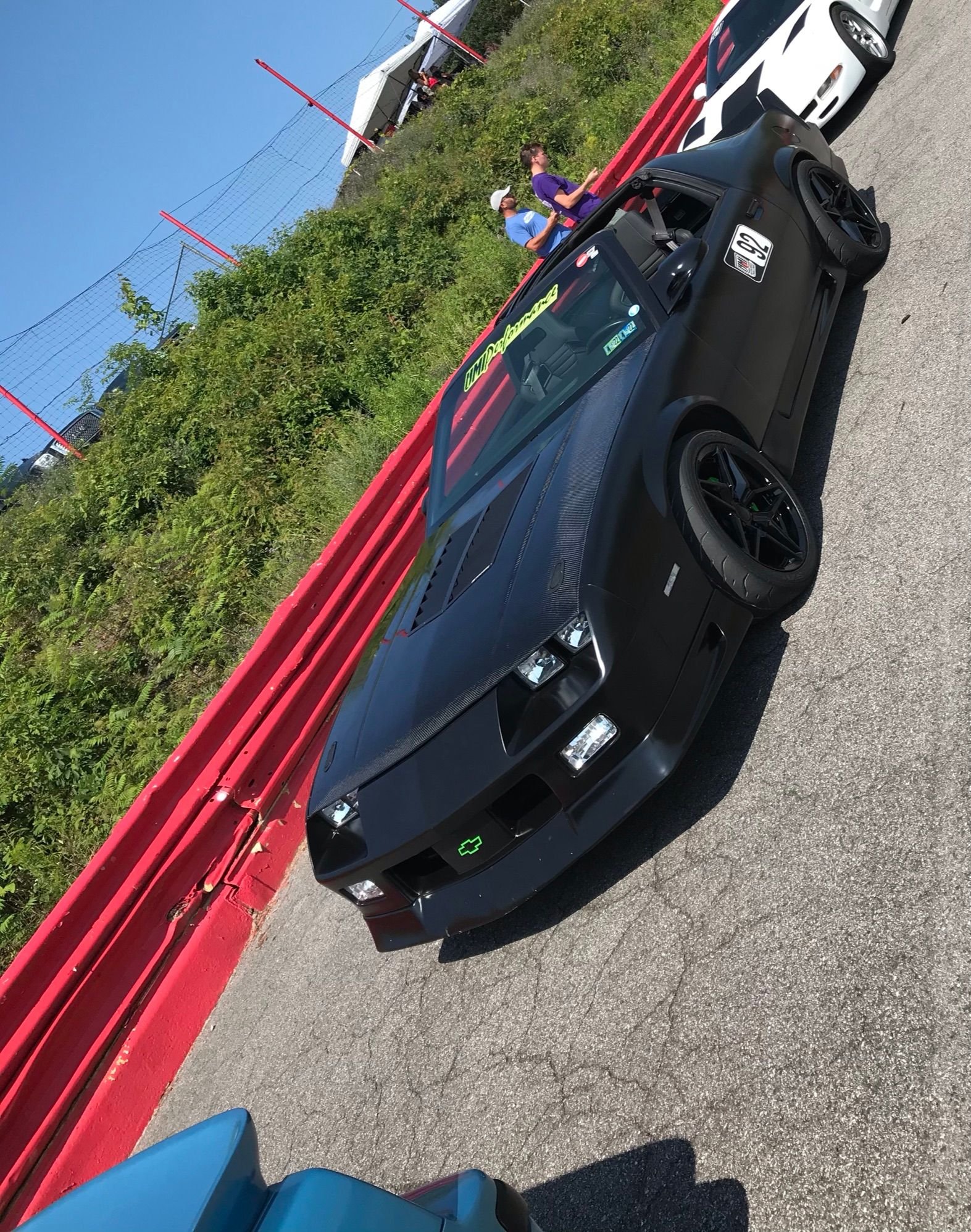

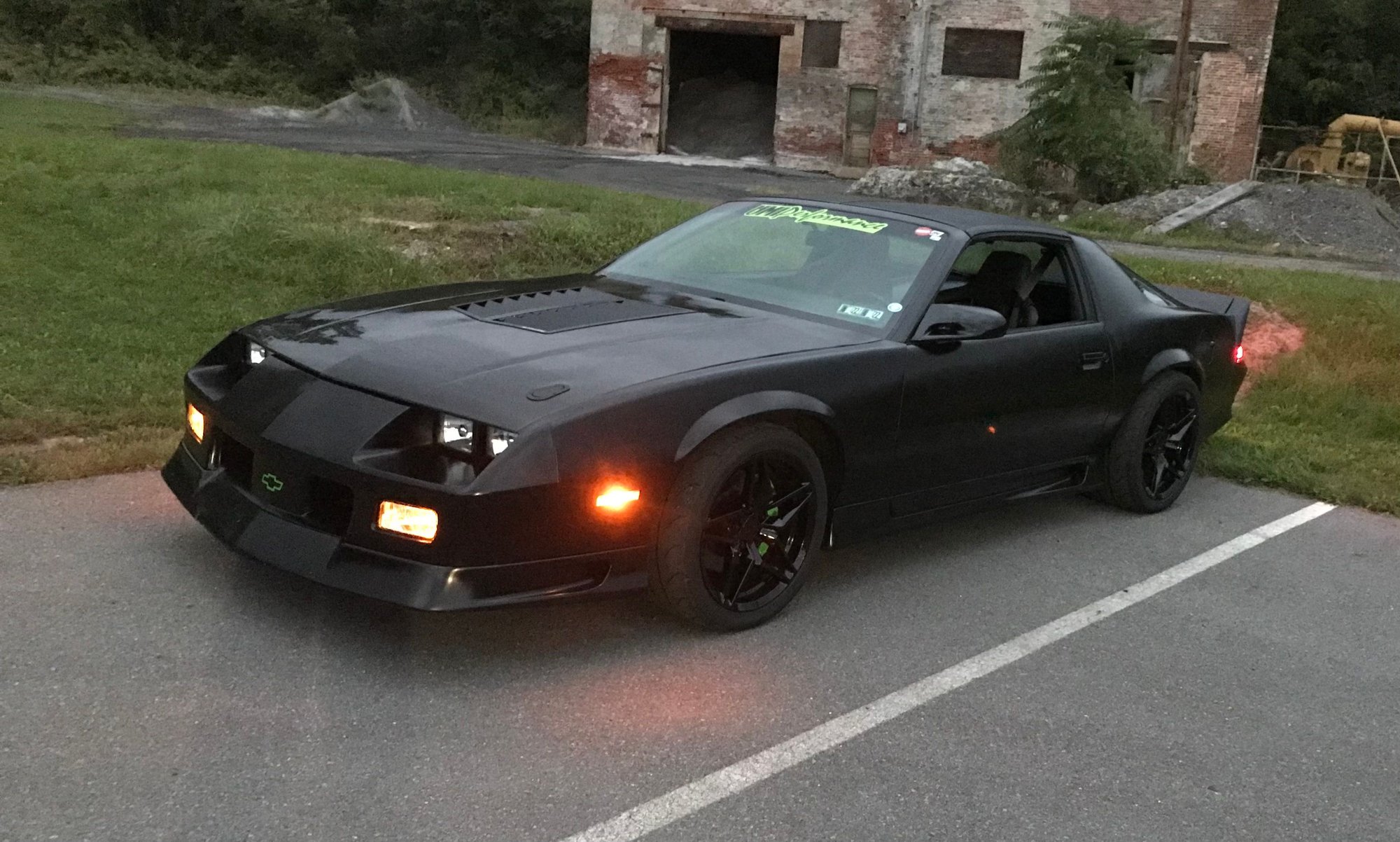

Guess I can add a few pics

From a performance stand point the car will respond better having equal specs.

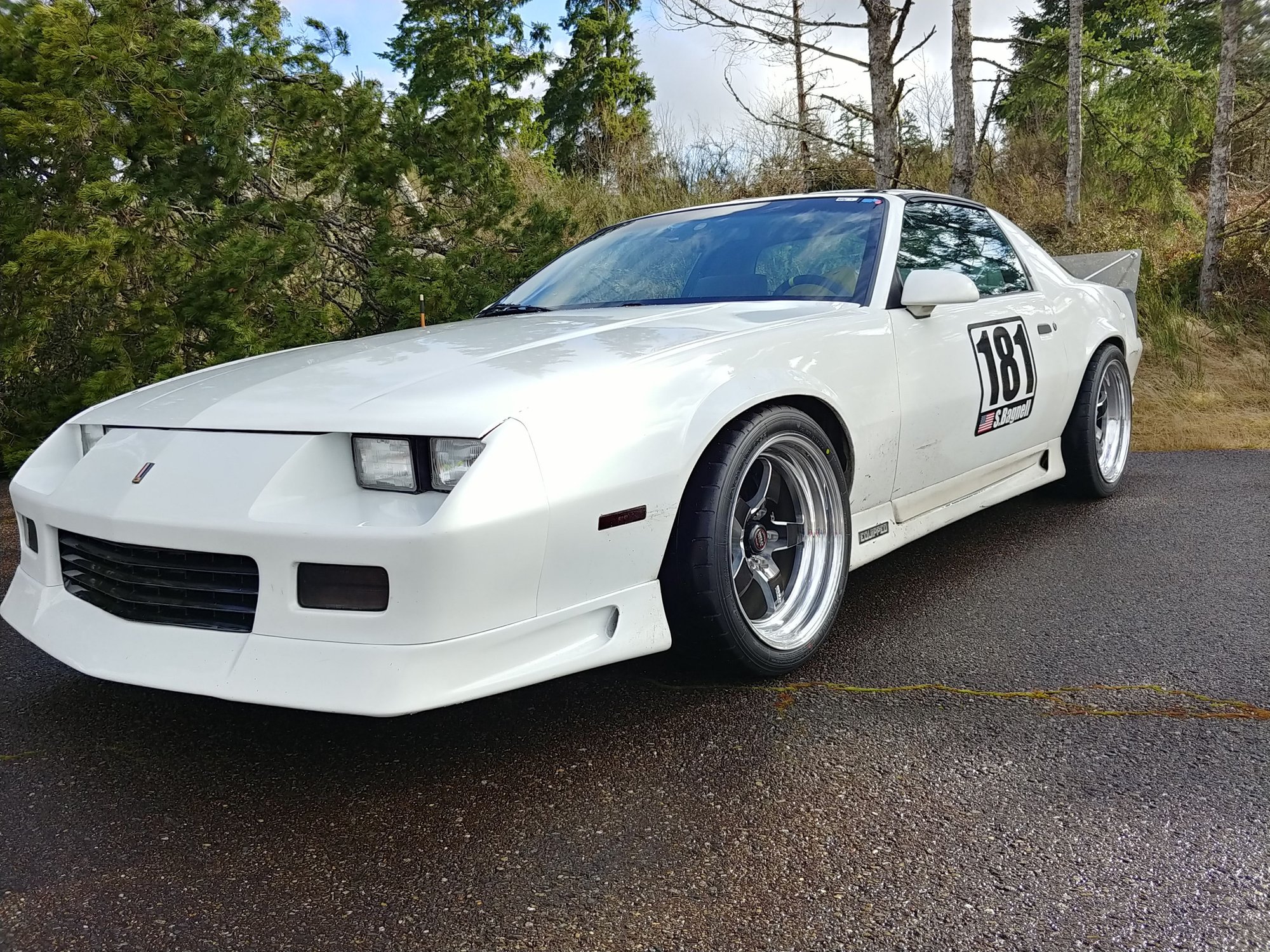

I ran my Autocross car at around 24in ride height and it was actually slower at that ride height due to the LCA angles going to sh"it.
The tires in this pic are 25in tall, so pretty short compared to stock and other common sizes.
83 Crossfire TA
