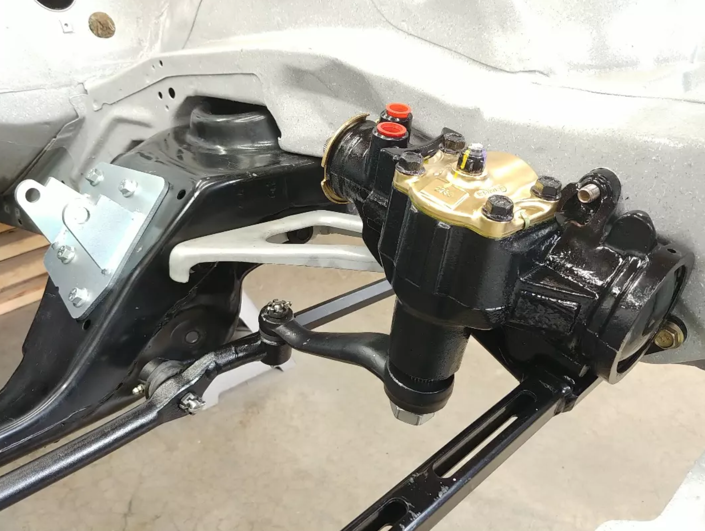

I use one of these larger ones.
ITs like $10 from harbor freight.
20 seconds and the spindle will be free.

Harbor freight sells two of them. there's a small and a big one, it's just the big one.
Although I recommend buying both sizes because you can use the small size on the tie rods.
You can also rent these from like AutoZone's or O'Reilly's

Yes, those things are handy. I use them on steering linkages. Pops them out without all the violence of a hammer. I think the big one also fits the steering box if I remember right, so quite handy to have both sizes.

Ya, the Big one fits the steering box pitman arm.
If the pitman arm has been installed for 30+ years; it requires some heat to remove even with the puller.
