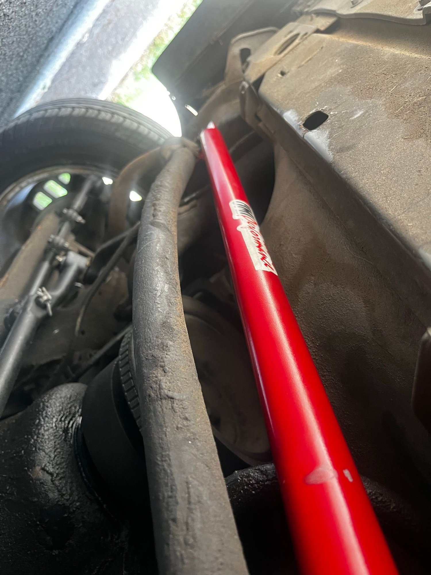

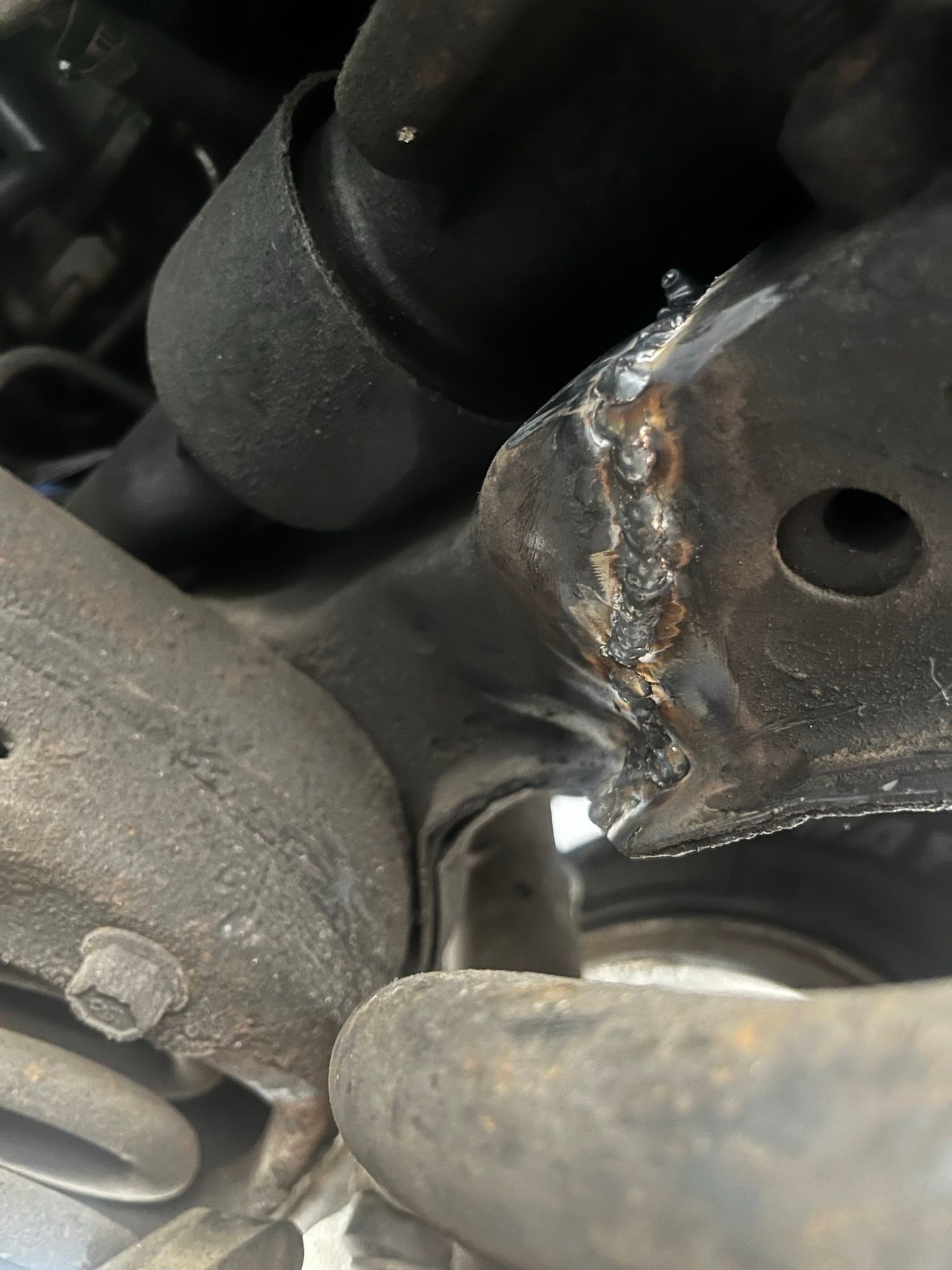

Need more thoughts!!! I have an 83 se. Been tackling a front end clunk for the longest time. First by replacing all the old worn out steering components. Fixed some of the clunks. Then I saw that there was a crack at the frame rail near the steering box (not behind it, just near it.) welded that back up, and added a wonder bar. Fixed another clunk. Then, replaced both the lower ball joints hopping to solve the last clunk. Nope. Then I tightened up the k member Bolts and sure as **** the clunk is gone. But right before I did that, this creak started. It’s coming from the driver side near the steering box. I cannot see any other cracks, I can’t see where the frame rail might be twisting either. I can see the whole thing sways a little bit side to side when someone turns the steering wheel and that’s it.
I only have two thoughts. There is another crack behind the box somewhere, or the frame rail is flexing behind the box towards the driver side and I need to find and install those triangle looking braces from the k member to frame rail. I’m about ready to make this car faster but want to sort out the other stuff first.
