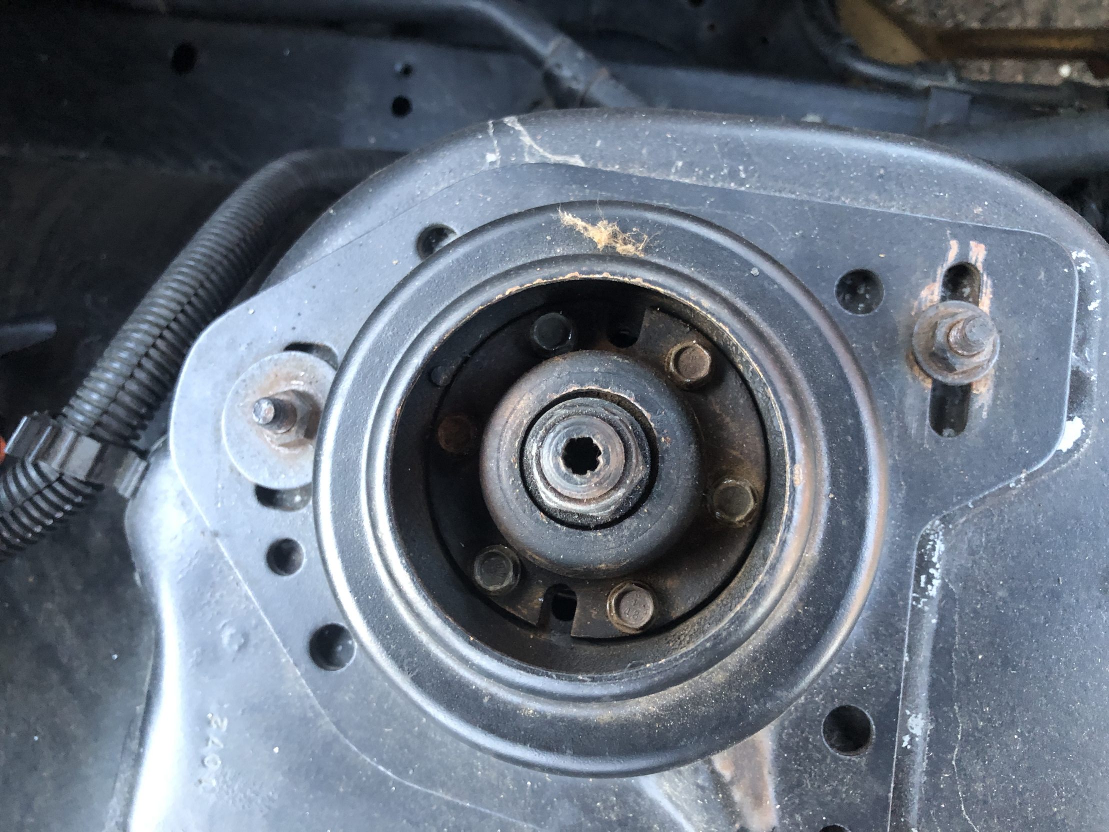

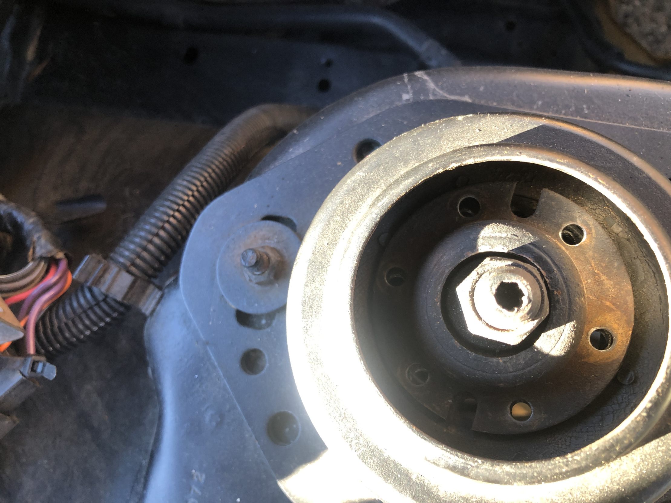

While I can't avoid them all & do hit potholes from time-to-time ( RI Roads are NOT the best ! ) I managed to hit one the other day without warning and needless to say,.... it caused some problems !
After removing the remaining chunks of aluminum that were left of the original 6 rivets that hold that "hat" in place I found some replacement hardware that I could use to get back on the road again. I decided to use 6 8mm fine tooth bolts (hood cable handle-to-body hardware) and 6 8mm nuts after cutting the washer off (hatch fin hardware) from the hardware bin.
Jacked up the car and 'lined up' the bearing, hat, and strut:
Then tightened-down in an crossing sequence so the hat would 'fit' to the bearing properly and now I don't ever expect that strut mount to be a problem ever again.
Found a little play in each of the front wheel bearings too so I torqued them 1 more 'notch' of the large nut while I was at it. I wish all Sunday afternoon Thirdgen projects were this easy ! Back in the saddle Baby !!

Took the GTA out for a little use & abuse yesterday and the front end held up and everything felt nice and tight. I'm real thankful that nothing worse came from this !!
Komet: I had briefly considered installing some aftermarket Strut Mounts as this is the perfect 'excuse',.... but I've got a few other more-important things I've got to focus on in the near term so any upgrade will have to remain on the wish-list for now.
TL: When I first hit the pothole my first thought was a blown--out control arm bushing or sumthin' like that. when I didn't find anything after a quick peek under the car I expected I'd find a blown strut,.... and was just about in shock when I saw the strut mount was the problem. I've blown tires and bent a rim on bad potholes before,..... but this 'takes-the-cake' !!
QwkTrip: I've got a couple spare pairs of original strut mounts; so while I appreciate the offer I just don't need them. The reason I didn't install a used replacement is simple,.... I recently re-aligned the front end after a complete rebuild ( can see the marks on the strut tower mount & hardware ) and since I'm out of work ( medical ) right now I'm not at the shop and would have to pay for another alignment rather than being able to do it myself. I could have gotten it 'close' by marking the busted strut mount; but this "fix" seems to have allowed me to keep the current (good) alignment & that $100 alignment fee in my pocket !
** I'm gonna' be at my bench doing some radio work later today. when I get back online later tonight I'll send you a message regarding your current radio. If you rear this before I send you a PM; Send me a quick PM and let me know if you have a cassette no EQ or a cassette / EQ style radio.
DynoDave43: Can't say there really is another weak point to the original strut mounts. I'd have to guess that the bearing itself ( sandwiched under that "hat") would probably be the weakest part of the whole assembly; AFTER the aluminum rivets !
