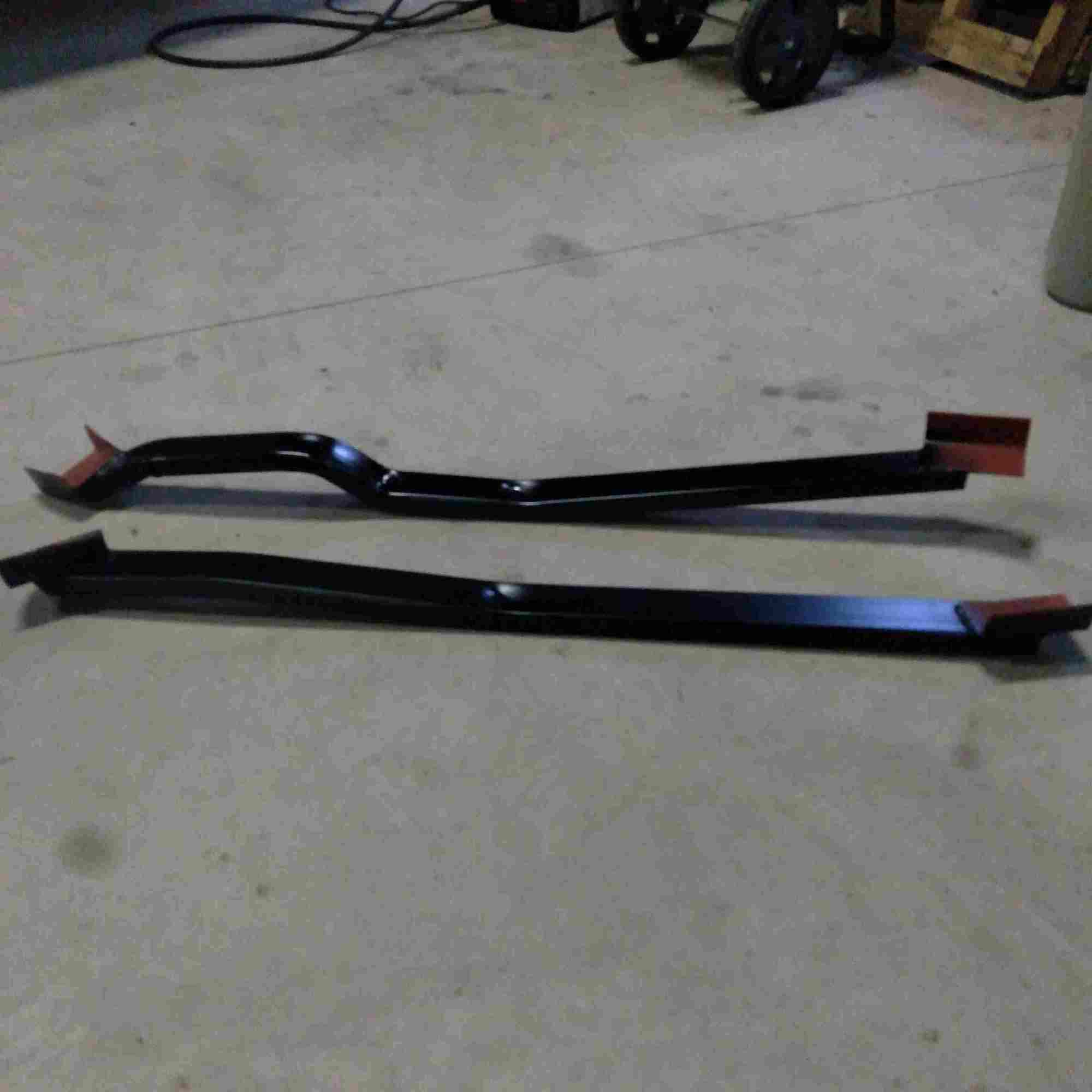

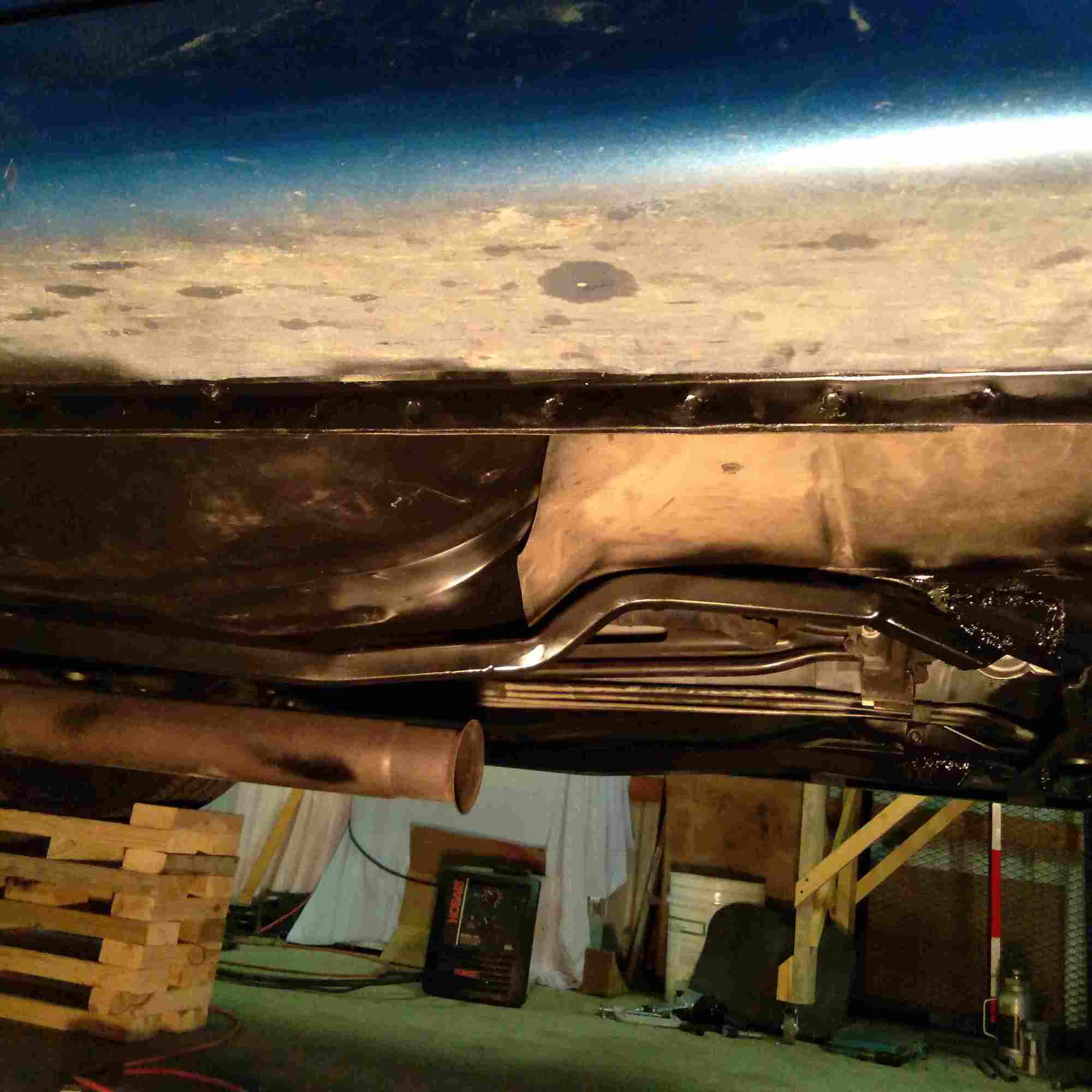

I finished my SFC today. I used 2"X1"X1/8" tube & some 2"X1 1/2"X1/8" angle iron. Welds aren't the prettiest but it will definitely stiffen things up some. The exhaust is lower than the SFC and it's tucked up tight. In the pic the exhaust is hanging low because it's not hooked up.

Looks nice!
