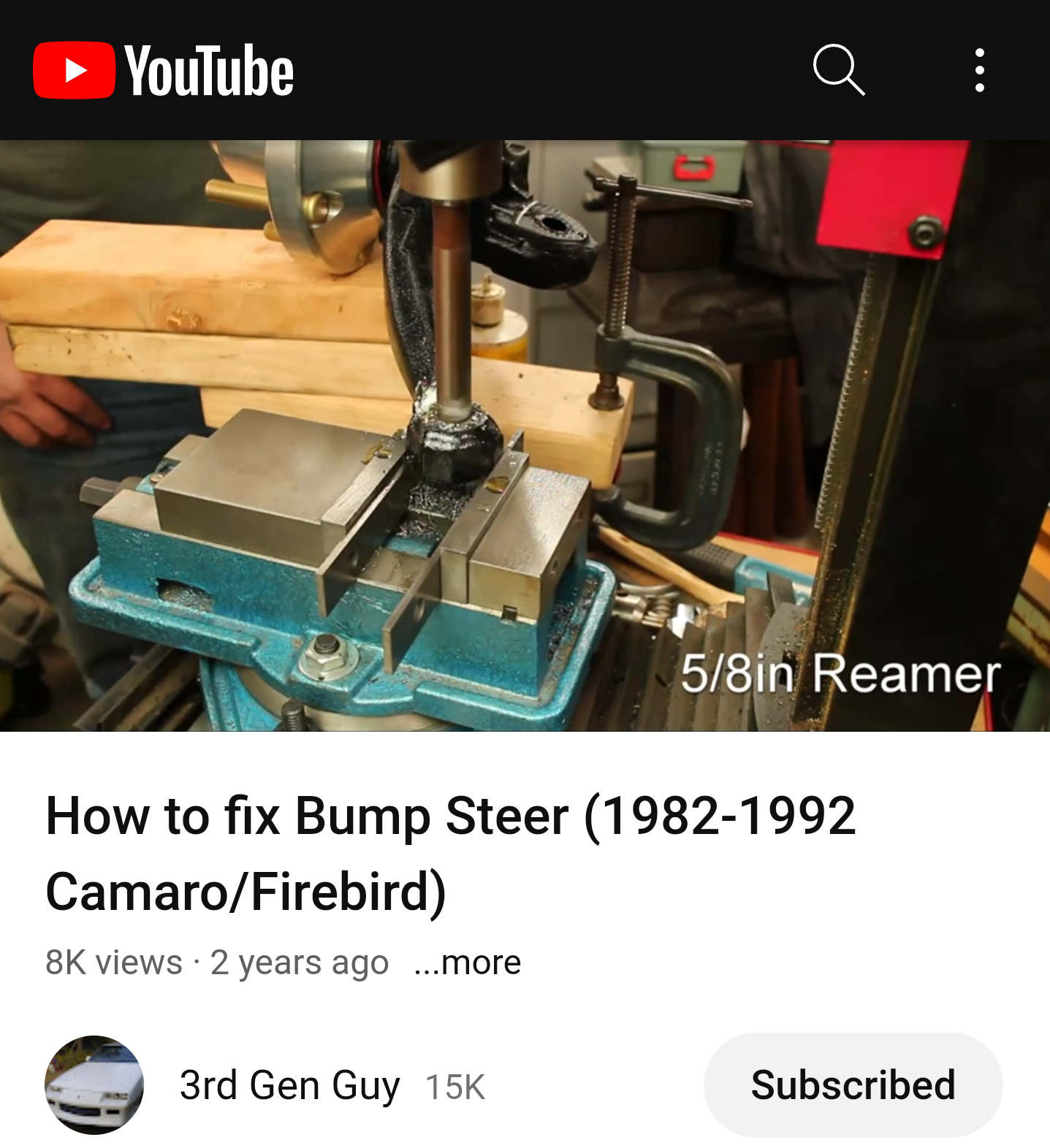

Looking at this picture from this thread https://www.thirdgen.org/forums/susp...ml#post6490887
With all the complaints about how tight it gets to the side of the rim, has anyone tried drilling the hole offset inward? It seems like it would be easy enough to do on a mill and the taper appears small enough that you might be able to offset things as much as .2" or so, and there appears to be plenty of meat there not to end up with too weak a part.
