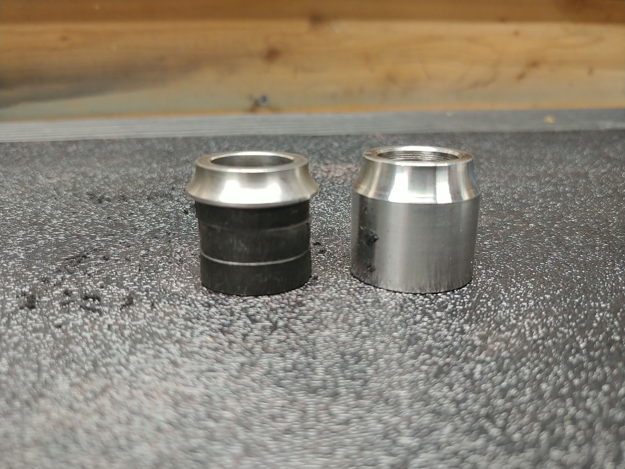

316 stainless bump steer shim made by my buddy in his CNC lathe.
