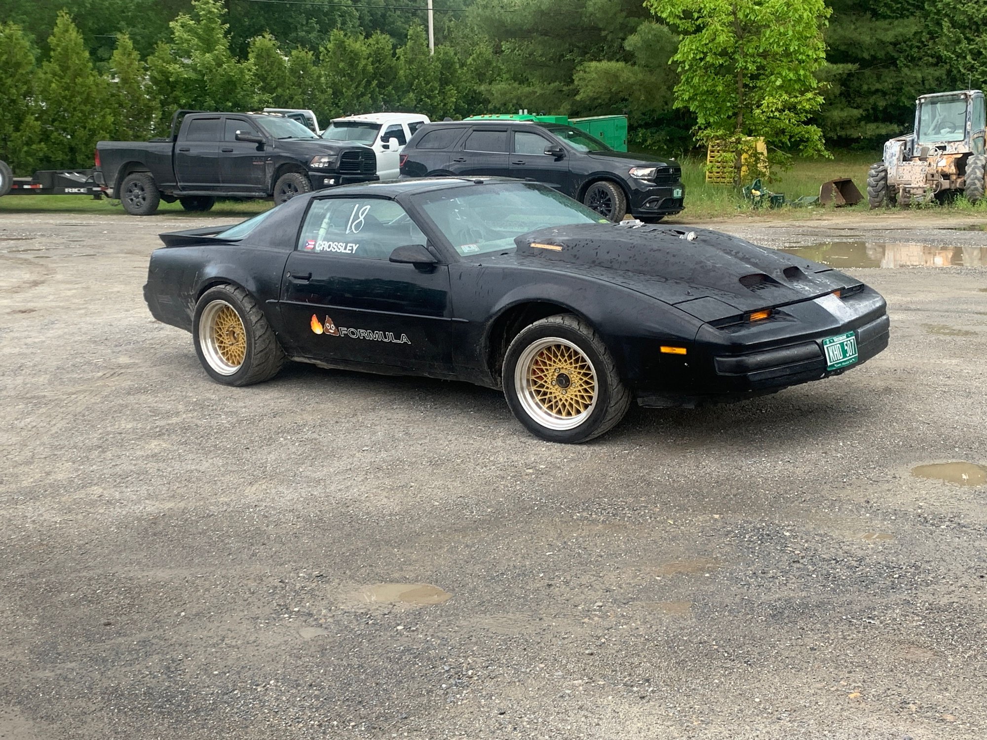

Hi guys! New here and looking for some info. First things first my setup. I’ve got a Frankenstein of a 3rd gen formula. Purchased the car running and driving. Previous owner bought it as a shell. It’s an 86. It’s got spohn tubular k and control arms up front and spohn adjustable control arms in the back. Car had a lq9 in it. Previous owner put a t-56 with a ten bolt torsen from a ls 4th gen in the car. I purchased the car for spectator drag racing(head to head circle track). Since I’ve owned the car I put a 12 bolt from a 4th gen,4:11 gears, rear double adjustable coil overs, rollbar,fire suppression, 4l80e all behind a aluminum 5.3 out of a gmc envoy. Motor is cammed and running a m122 supercharger from a gt 500 mustang. Car runs e85 and is controlled with a holley terminator x. Right now she is a touch under 500hp and 500 foot pounds to the wheels.
Now my question for the guys who know these cars much better than I. Do fourth gen or corvette spindles work on these cars? I ask because I’d like to add a front wheel sensor to add traction control. Any of you guys done it here? What setup did you use if you have?

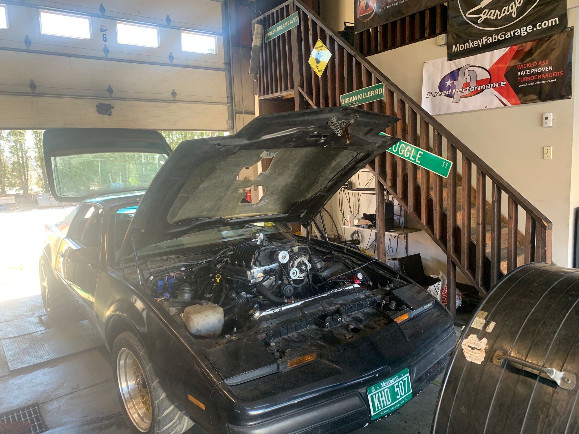

View behind the curtain

There is a lot going there with that blower. I was wondering how you adapted a ford blower.
