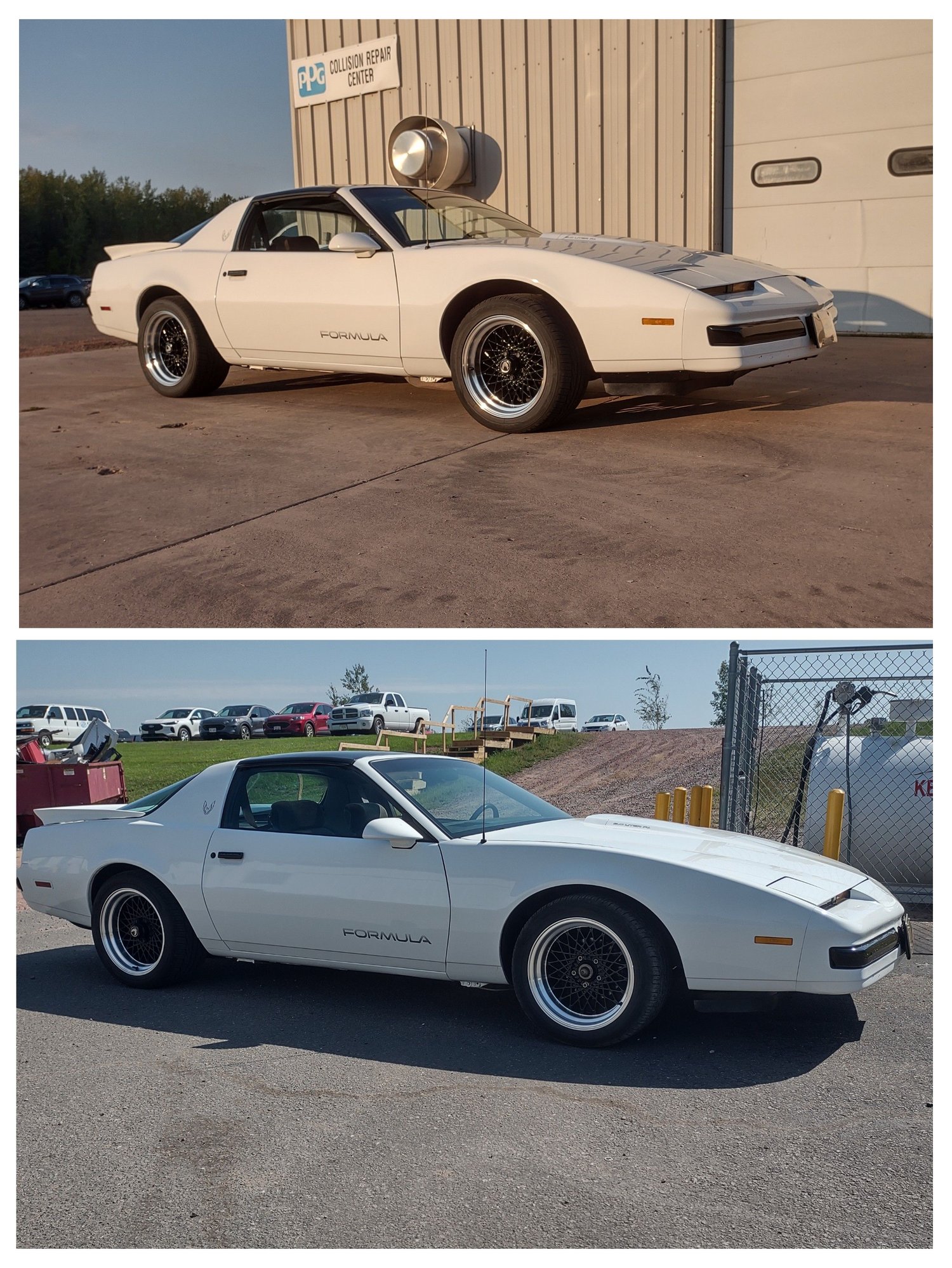

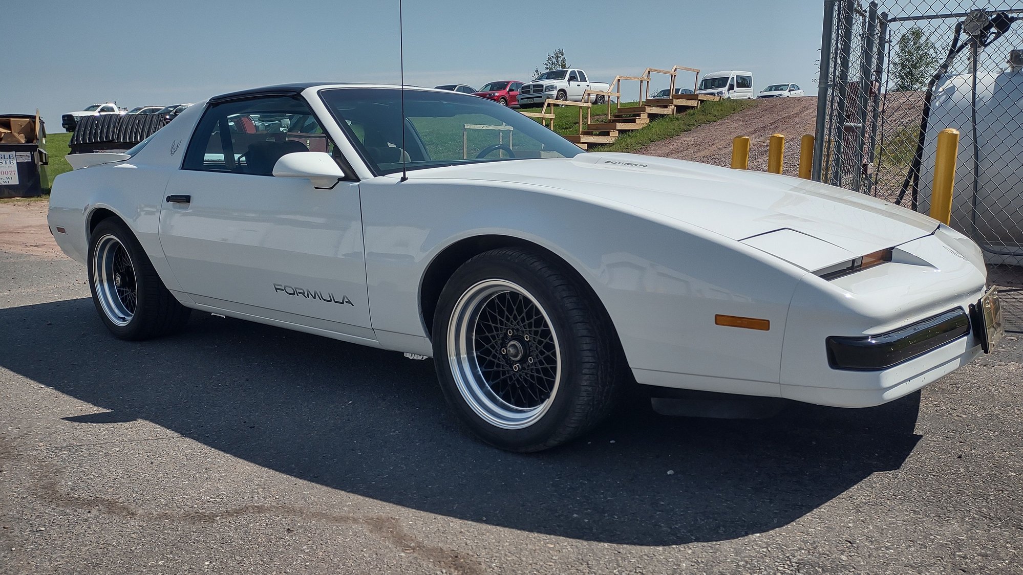

Did a few modifications to my Firebird over the summer to the suspension. replaced all the old worn out parts and bushings, plus added a few performance parts as well.
Pictures of the car before and after sitting on the ground. Parts list used on the car. I was right around $1600 with doing the work myself with the help of a couple friends.
The only real problem i had was with the Moog tie rods being to long on the driver side, which I cut about 2 inches off that tie rod.
A few pictures below along with some links to video i did on them.
Takes the bumps like a champ and handles wayyyy better
Let me know if you have questions or comments

Before and After
After, before alignment
After alignment
Before

Very nice. Hefty parts list but imagine if u payed for labor. Im sure it drives nice and tight now, did my front end a few years ago and what a difference it made.
