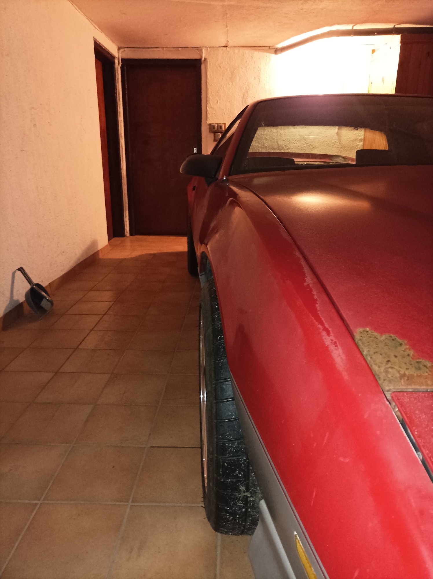

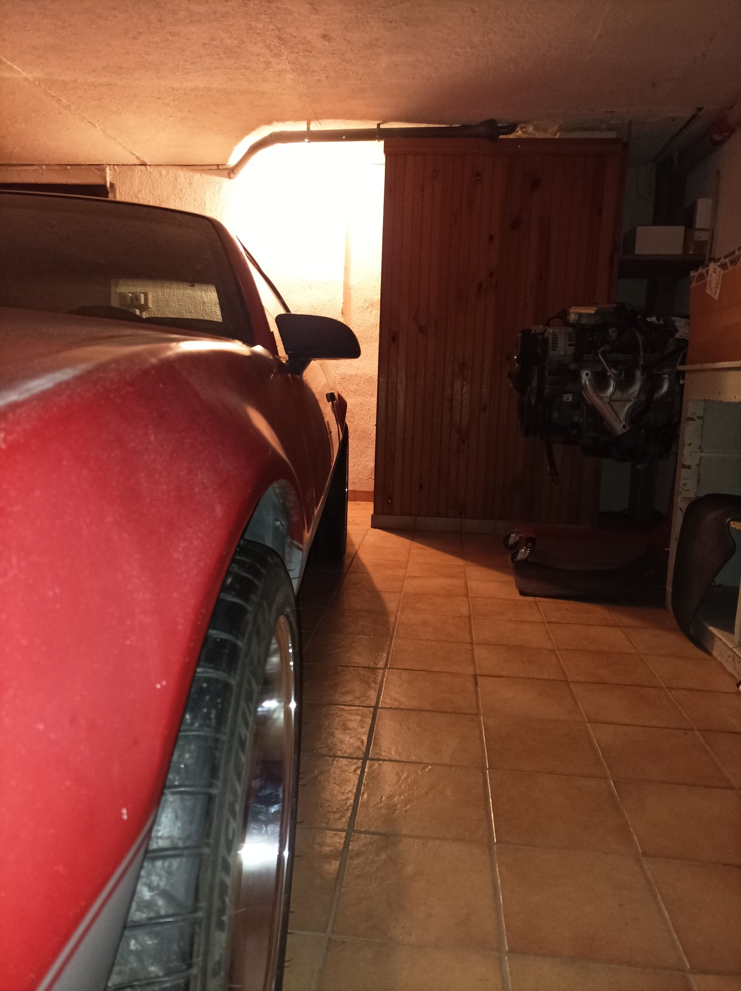

Hi everyone !
Is there anyway to narrow the track width on 3rd gen ?
I installed 18"x10" ET00 wheels on 4 corners. Tires are almost out of the fenders ?
I will do brake upgrade later and don't want the wheels to stand out.
If you guys know any means to do so, don't hesitate.
Thanks

Looks close, add some camber.

Have you tried to turn the wheels to look for interference? Is there any contact any where? Most people w 18x10s are looking for some pretty aggressive driving and usually mod the car quite a bit. I have 18x10s rear and 18x9s front on my 82 TA. It's on weight jacks and is petty low, there's very mild rubbing up front when at full lock. Do you have a side view showing how much the wheels stick out? In the pic you have, they don't look that bad.

Front tires are rubbing on fender wells (frt and rr side of the fender wells) at full lock.
I Will modify the car in the future but i'm not in a hurry.
I'll take pictures and post it tonight.

Here are the pictures.
i checked the camber using a bubble level. It seems all wheels have tiny positive camber which surprised me concerning the rear.

Those wheels just stick out a little too much. My wheels are about 1/2-3/4 inch in from yours and mine are really close to rubbing. I think you have 3 options. New wheels, new fenders/quarter panels or don't turn or hit any bumps.
Your car looks like a mecum trans am. If it is, I'd get different wheels and not cut it up. Those are cool cars.
