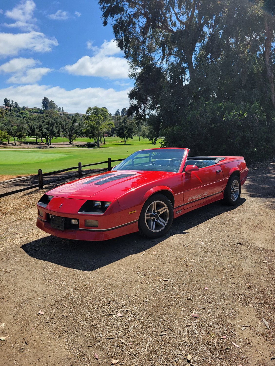

Recommend suspension Upgrade
For a 1987 IROC. I would like to keep everything stock as far as height is concerned. Just need a better ride quality.
I did a search but the results were old. Part #s would be great because I dont know the length and specs.
