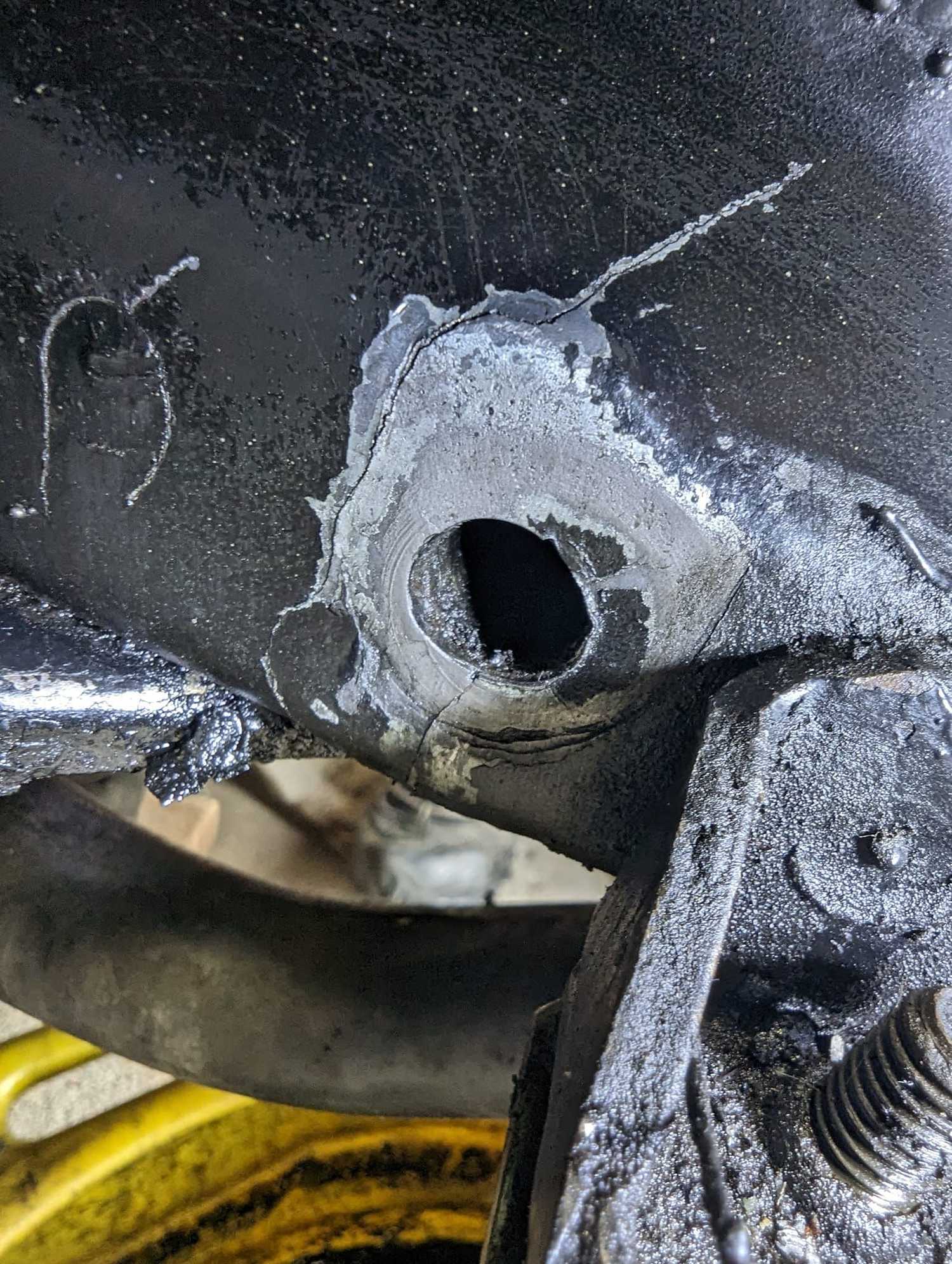

Re: Frame rail stress cracks by steering box ??
I doubt it's going to be cracked from normal driving. Autocross, road racing and track days, maybe, but unlikely otherwise.
My car has been autocrossed since the late 1980s and only developed a crack 3-4 years ago:
17X11 wheels on Hoosiers autocross tires from 2011+, and 16X10s with whatever Kumho/Hoosier/BFG prior to that.
Pat

Sadly, in my years I have seen this happen to a few( maybe 3)F bodies generally older than 1986. Most had power steering issues that put a lot of stress on that area of the frame but is easy to repair by a good welder.
