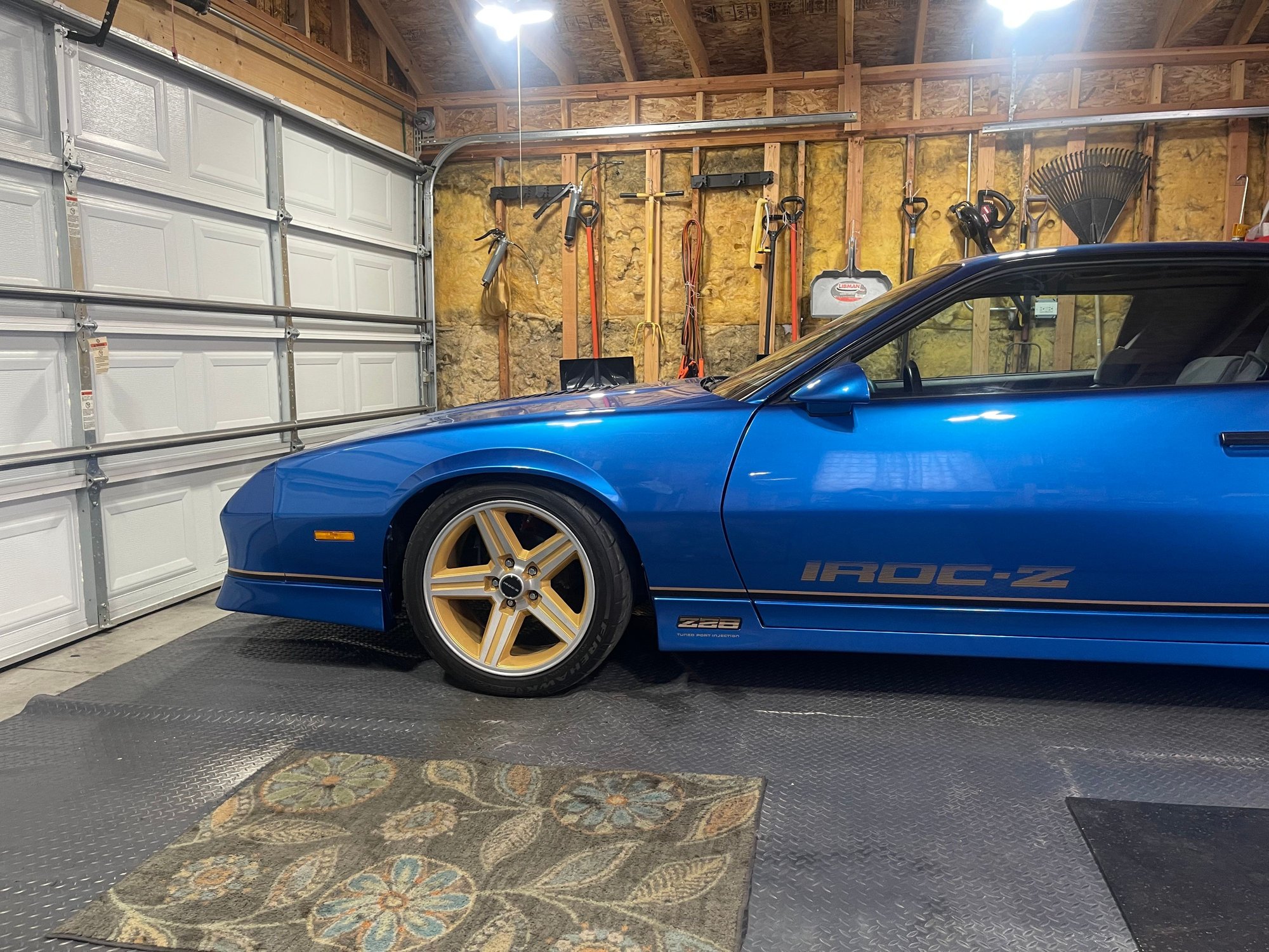

Old May 9, 2026 | 02:48 PM
Thirdgenstudent's Avatar
Joined: Jan 2024
Posts: 104
Likes: 8

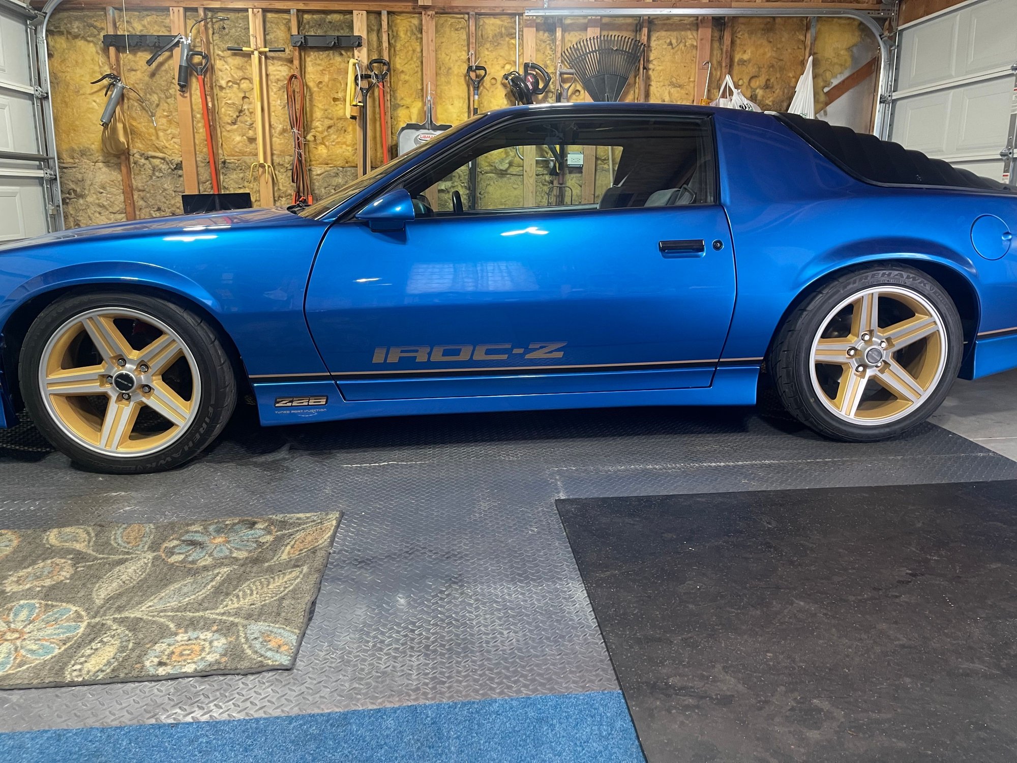

Re: UMI weight jacks

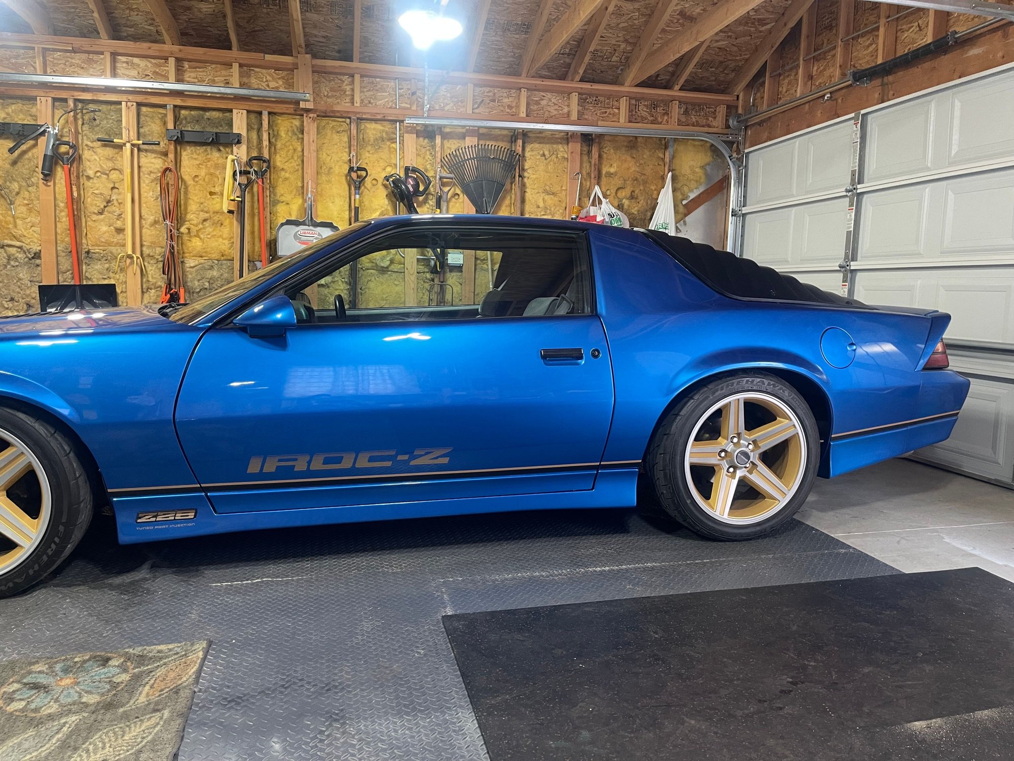

Old May 9, 2026 | 02:50 PM
Joined: Jan 2024
Posts: 104
Likes: 8
Old May 9, 2026 | 02:52 PM
Joined: Jan 2024
Posts: 104
Likes: 8
Update….lifted the rear 3/4” and it drove great! I guess you just can’t have it too low or it will bottom out…I’m happy with the stance and the ride. Thanks to everyone for the advice.

Old May 9, 2026 | 06:20 PM
CamaroZ_85's Avatar
Joined: May 2000
Posts: 701
Likes: 63
From: Central NJ
Originally Posted by Thirdgenstudent
Is this before or after raising it 3/4"? Looks good!
Old May 11, 2026 | 12:02 PM
Joined: Jan 2024
Posts: 104
Likes: 8
After and thank you
