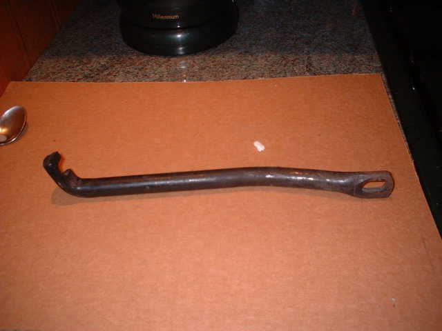

Hi all.
Just putting a 1977 350 in my 1991 RS. The LO3 that used to be there is long gone but the ancillaries at the front are almost complete (got missing bits imported from thidgenparts). So I am fitting 1991 ancillaries (water pump, alternator, A/C etc) to this engine. BUT, I have this reinforcing rod that goes where?
It is not the one at the rear of the alternator.
HELP.
Thanks.
Andy.

That looks like the support that goes from the back of the alternator to the exhaust manifold on the drivers side. Or it could be the one that goes from the bracket where the air conditioning compressor on the passanger side down to the exahust manifold. See here in the picture.

defiantly the air compressor piece i have seen it way to many times that why i got no more air pump!!!!!
Chris.

Thank you both!
Superb photos.
