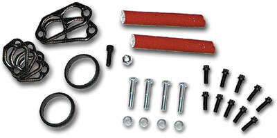

After looking further into things, I found out that the Install Kit I need is only $45. It comes with a number of things, Including detailed instructions on the install (a big plus).
Where is SCE? The advantage I have goin with SLP Kit is that I can drive the hr. there and pick it up. I only have another week to get this done.
Here's a pic of what the Install Kit includes ...

Looks like u will still need exhaust gaskets. If you go to the second site in my sig and go under exhaust you will see the part numbers at the bottom.
Old Aug 27, 2002 | 01:10 PM
gettaway305's Avatar
Posts: 117
From: Oregon
Car: 1989 Camaro RS
Engine: 305 TBI
that kit has the exhaust gaskets (the little black things)

ok heres my two cents.
dont get the kit. heres why, you can buy mr. gasket ultra seal exhaust gaskets at your local autozone or whatever. while your there you can pick up new headers bolts. detailed instructions.... you dont need them its a very easy intstall. BUT heres why you should get the kit. those headers dont have standard collector gaskets and bolts. the kit comes with the right ones, because autozone or whatever might not have them. so now that i think about it get the kit if NO local place has the correct collector gaskets and bolts.

I stopped at my exhaust shop yesterday to see what he thought. He told me that basically I could buy the Kit if I wanted too, but I would be wasting money. He told me to go to the local performance shop, pickup Mr. Gasket Ultra Seal Gaskets and some Header Bolts. He told me that he has the rest of the stuff for me. (Prolly free since I do all his books at work). So, needless to say, thanks for all your ideas guys. Looks like I wont be buying the kit.
