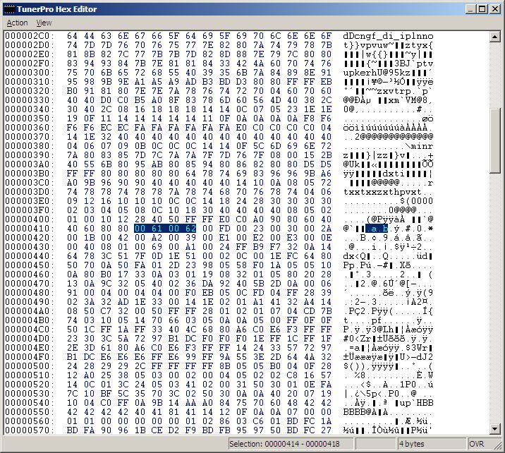

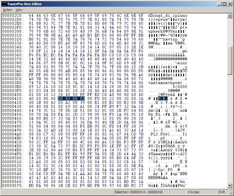

Then to get the sync PW on the ALDL line make these changes at the addresses shown:
Addr: Value:
$D4E7 $00
$D4E8 $AB
$D4E9 $00
$D4EA $AC
Same as above, different locations and different math.
Addr: Value:
$D414 $00
$D415 $61
$D416 $00
$D417 $62
RBob, what exacly is stored in $AB, $AC for the PW and $61 and $62 for the timing? Ive been trying to get the PW to output but trying both the locations for the 7747 and 8746 ive had no luck. I ahd some luck with outputting the timing but the address $61 just returns zero. The second returns the timing thats called for by the main spark table in the ecm. As for the PW, I did get something that varies with the engine load/speed but it looks more like a value used in the air flow rate calculations since it goes up to almost 255 hex. Maybe if i know what to look for i might have more luck.

Originally posted by dimented24x7
up she goes...
IIRC you are using the '8063 ECM. Ignore the '747 locations/values, they won't even be close. You can try the '8746 locations & values and it may work, but then again it may not.
The '8746 locations are:
$61 and $62 for the SA
$AA and $AB for the PW
As for the SA location $61 will be zero unless the SA is retarded from TDC. I usually replace some other ALDL value (like x-counts) with just the LSB ($62) of the SA. Then put the PW on the PROMID location.
I do this with the PW as the MSB of the PW will be zero up to 3.9 msec. Once greater then 3.9 msec then the MSB will be greater then 0.
Remember that the scan tool will display the values in decimal. Just do the math on them and you should have the correct final value(s).
Another problem you may be having is the location of the ALDL stream table within the bin. You can verify the location of it as the PROMID bytes will have the values $D0, $02, $D0, $D3 ($D002, $D003) as the first set of addresses to be sent.
RBob.
Addr: Value:
$D414 $00
$D415 $61
$D416 $00
$D417 $62
The math will be the displayed PROMID value * .352 + the initial timing as set in the bin.
So a PROMID of 91 and 6 deg of initial = 91 * .352 + 6 = 38.0 deg SA.
If you want the PW then use $AA and $AB instead of the $61 & $62. The math will be as it is for the '747 above.
RBob.
Note: this is to place the SA into the ALDL stream for the '8746 ECM. It will be in the PromID field.
Due to additional interest in this, here are two screen shots of before and after. What a stock BIN has in those locations ($D0 $02 $D0 $03). Then the SA being patched in.
Be sure to commit the change, change another parameter via the XDF (even if back to the same value), then save the BIN. The changing of a parameter via the XDF is so that TunerPro is forced to re-calc the checksum.
RBob.
