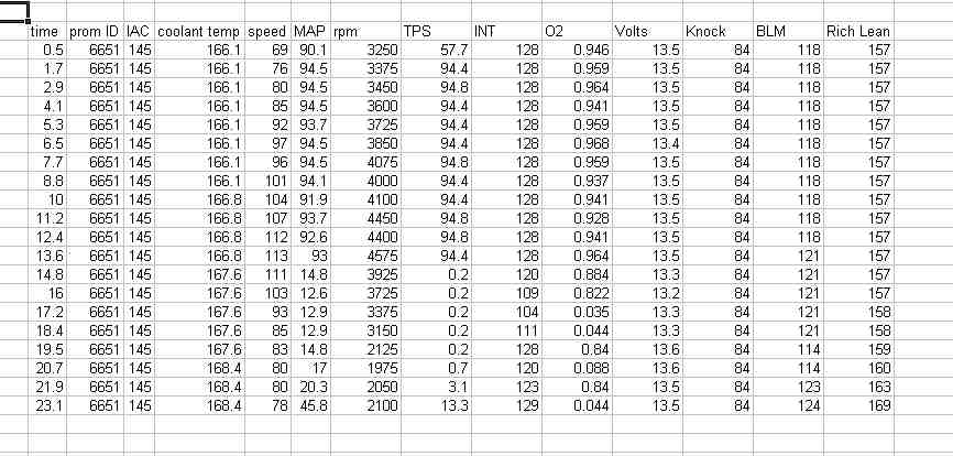

Here's my 3rd gear log. It's a roll from about 60 to 105 the mph figures are 10 mph fast.

Old Nov 18, 2003 | 03:27 PM
Dewey316's Avatar
Posts: 6,577
From: Portland, OR www.cascadecrew.org
Car: 1990 Camaro RS
Engine: Juiced 5.0 TBI - 300rwhp
Axle/Gears: 3.42 Eaton Posi, 10 Bolt
had you started to break up on that log? at what RPM did it start to have the problems?
although every 'looks' failry normal.

Yeah it broke up as usuall a little at first right at 4 and got real heavy right before I let off. Sorry the log is so short I had my friend runnin the lap top while I drove.The only thing I can see is the map reading wavers just a bit.

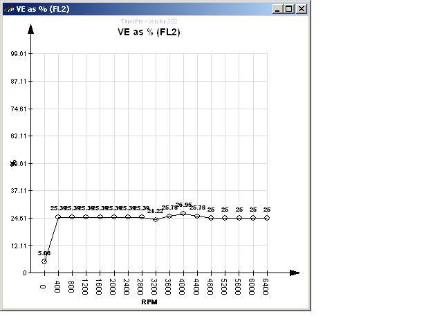

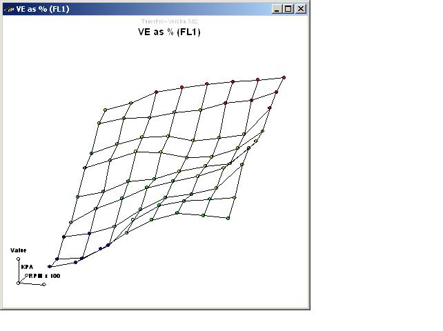

Old Nov 19, 2003 | 12:25 AM
Dewey316's Avatar
Posts: 6,577
Car: 1990 Camaro RS
Yeah, i'm guessing lean also.
i went ahead and attached the graphs of your fuel maps. notice that right a 4k, you fuel actualy goes DOWN (using the 3200 cell on VE table 1 + the VE 2 for that RPM)
i would suggest either going RBobs route, or maybe initialy (easy test) is to give it some more fuel in the VE2 table over 4k.

VE2
