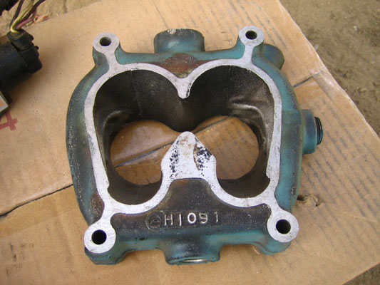

If someone told me that Gm made an adapter for a TBI to Quadrajet I'd have said "Codswallop!"

Its 1 3/4" thick and has a water passage built into it.
This post for educational purposes only.

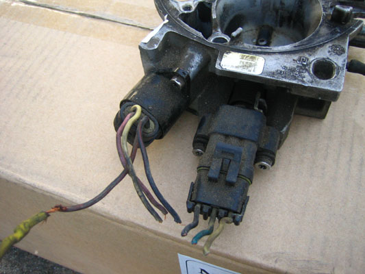

Wow, that's pretty interesting. Good find!
The IAC valve looks a little different that the usual kind you see on TBIs, I noticed. Do you have a better picture of it? Just curious.

I'm building a 400sbc and thought I'd tbi it. Then I started reading this forum and began to have second thoughts. (maybe over my head) so a carb is looking good but with this stuff I can go Qjet intake and work things out and go back to carb if I have to. Anyway I have an lo5 tbi and ecm but I really don't much about them. If you see anything that may be a problem from these pics feel free to point it out. thanks
