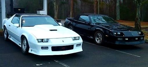

LOL- this thread was bumped after 19 years!
Well seems like ~ 21 years later it's time for an update being that I'm the OP.
Never made it back to the dyno with the L03. The car did get a tune up and ran a bit better. Later an SLP Dual/Dual catback was installed. Apparently it sounded better as someone at AutoZone heard the exhaust and wanted to know what all had been done to the 350...lol
The original 305 LO3 TBI proved bullet proof. When the RS was LS swapped in 2015, the L03 had ~389,500 miles on it. Drove the RS 800 miles to Hawk's Motorsports for the restoration and swap. The RS averaged it's normal 30+ mpg for the whole 800 miles It's still my understanding it's the highest mile 3rd Gen that's ever driven into Hawk's Motorsports for restoration with an entirely original drive line without any rebuilds.
In 2012 or so the LO3 got a set of valve cover gaskets and that fixed the only oil leak. Mechanic was positive it was a ~40,000 mile crate motor based on condition...lol. He even argued with me the motor had to have been recently replaced given its overall condition. If not by me then by prior owner. He was speechless when I explained I'm the original owner, bought the RS with 9 miles on the odometer.
Ended up keeping the old L03 and it sits on an engine stand in my garage. Several friends have 3rd Gens so my old LO3 serves as our back up motor...it's still leak free.
The white RS dyno 465 whp & 442 wtq after the LS swap and now has a T-56 & 8.8 rear end.
I'm happy with the now 400,000+ mile RS 😀
For a while I had another 3rd Gen...Black Echo that's also in the picture. Also a LO3 A4 2.73 gear car....after tune up...Black Echo dyno'd 125 whp and 200 wtq.

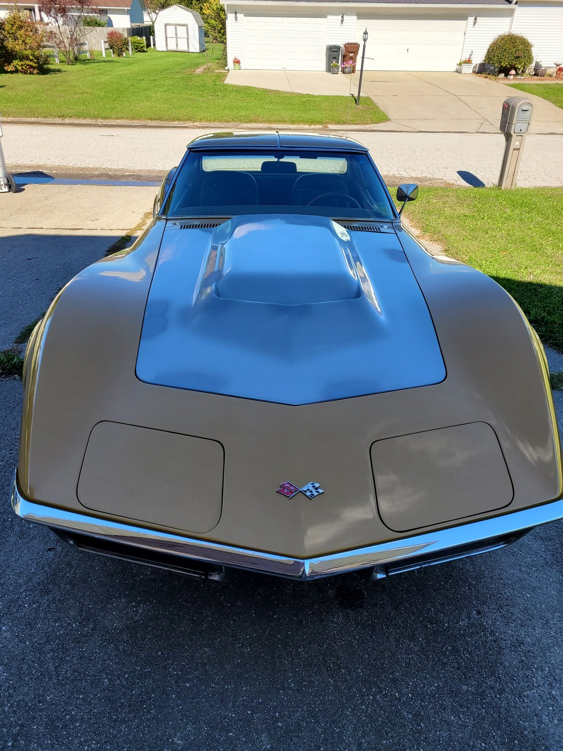

The 72 Vette mentioned, ended up with a Dart 400 and hopefully will see the paint shop soon.
