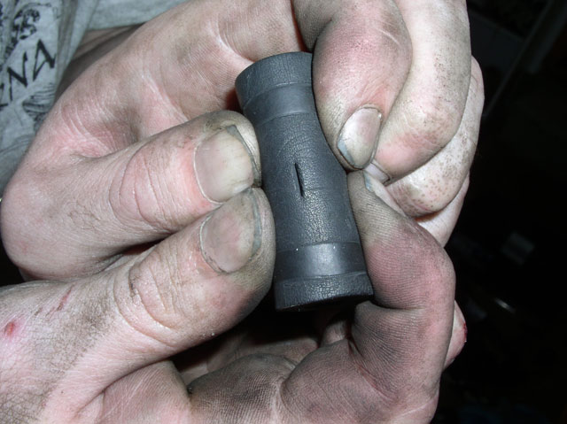

My car did not have one on it stock.
A word to the wise, check the little rubber line that connects the hardline to the pump, where the pulsator would be. I put in a whole new fuel pump, only to find that little line had burst, causing my loss of fuel pressure. for $0.30 you can get a new rubber line to go there, its worth replacing it for piece of mind.

its gotta be fuel injection hose though
